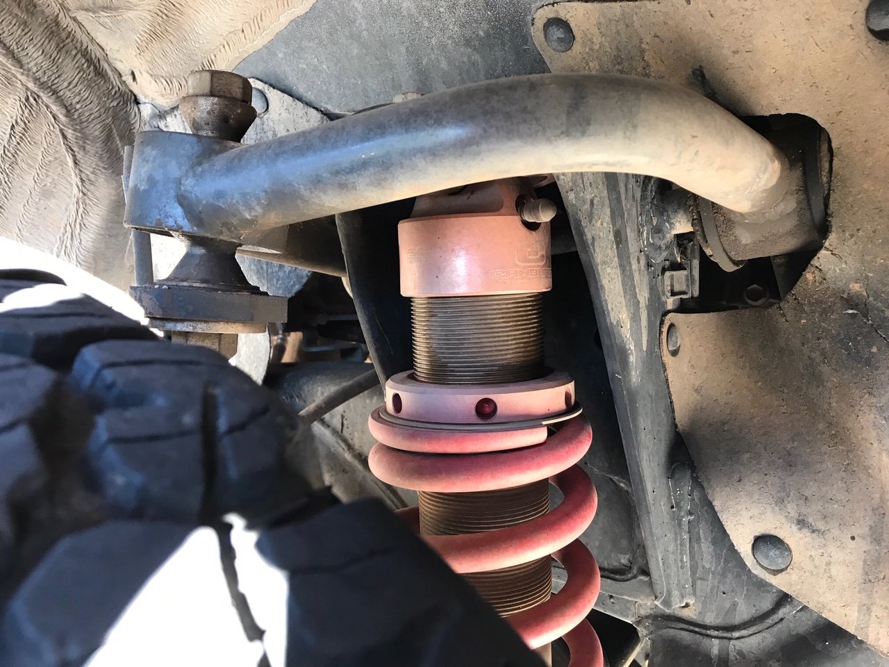

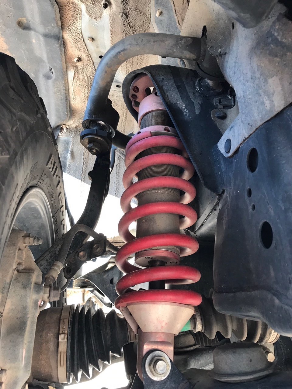

    He put some coil over shocks and an after market UCA on the truck.
    17D3BCBA-8EF5-49F0-9658-B7E7FA4A477D.jpg 104C074E-4134-44EB-AA21-956C617037D3.jpg
    The coil over says Camburg 2.5 series race ready.

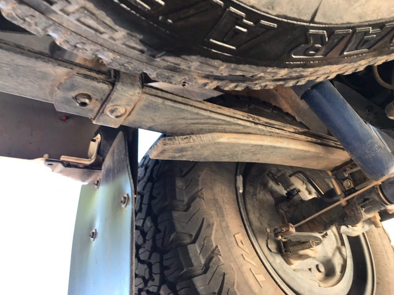

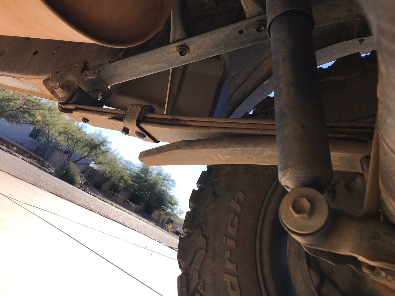

    My question is - the rear leaf springs loom terrible:
    DA547EC8-2903-4F74-8B72-45C80EA05EDF.jpg 4EDC67AB-6810-433D-AFBC-A22B938DE280.jpgIf I go with OME springs it will add 2.25 inches. Will this require me to put a new coil over on the front or can I adjust the existing coil overs. The truck sits about .5 inches nose high right now.

    Check out wheelers and pick an aal that would suit your needs. The ome springs will raise the back a lot.

    From what has stated in another thread, the rear springs will settle lower than 2.25 inches

    And if the front coilovers are in good shape, then you can adjust the height in the front to match the rear lift.

    those leafs look pretty good for stockers actually. usually these are flattened completely over the years
