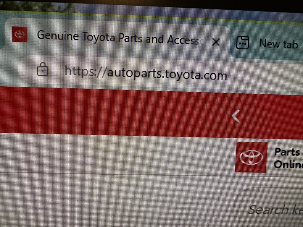

  12. Aug 24, 2024 at 2:03 PM

  13. Aug 24, 2024 at 2:09 PM
    #33
    javajunk-e
    javajunk-e [OP] Well-Known Member
    Aug 28, 2008
    #8847
    144
    So. Cal
    '09, Super White, DCLB, 4x4, Sport.
    Tacoma all weather floor mats, N-Fab Prerunner light bar w/ Hella 500ff lights, mag-lite mod, Hi-lift jack, Wet Okole seat covers, Revenge Fab sliders, ARE MX shell with Thule racks, and a Bed Rug.
