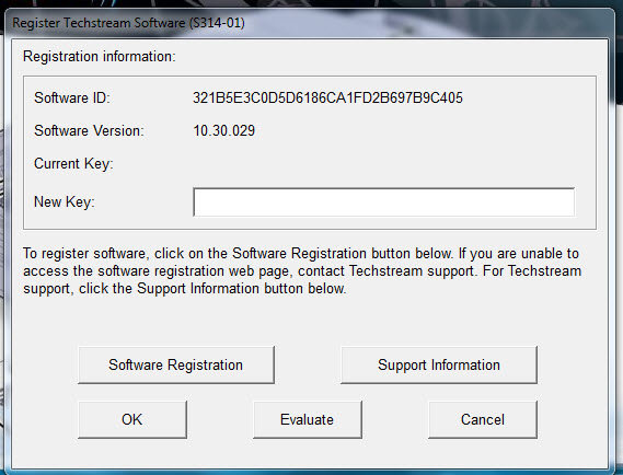

    So I worked through all of the installation instructions for the Techstream I bought from this fellow
    http://www.ebay.com/itm/301582918672?item=301582918672&viewitem=&vxp=mtr
    on Ebay a couple of weeks ago...
    Seemed like it was installed correctly, but when I tried to connect it to the truck I could not get past a screen that wanted me to register the software, or enter a registration key.
    Anyone have any quick help or hints on this one?
    Undoubtedly something obvious and easy that I am just missing.
    Thanks in advance,
    TjB

    I've looked at these pirated-from-China offerings a 100 times and came close to purchasing one. I read so many different accounts of what to do that I got dizzy.
    That said, many seem to have had success getting it to work. There are countless discussions on it at various Tundra and 4Runner forums. Many other Toyota yack sites as well.
    From what I can gather, getting past the password/registration thing requires that you use a specific hacked *.dll that's available at many of these sites. The challenge may be getting one that's compatible with your OS and maybe even more importantly the drivers. There's also mention of editing a text file - changing 1 to 0 or vice-versa.
    Keep digging.

    Replace original file "MainMenu.exe" with cracked version off the CD.
    Then start Techstream and go to "Software Registration" and paste this registration number:
    1111111111111111111111111111111110001511111111
    This code is for every area the same

    Thanks,
    I thought I had done the 1st step above, maybe it did not take when I did it, but it did this time.
    Then I did not need the registration number.
    Got the seatbelt chime turned off, will look at it in more depth later on and see what else I might be able to alter...
