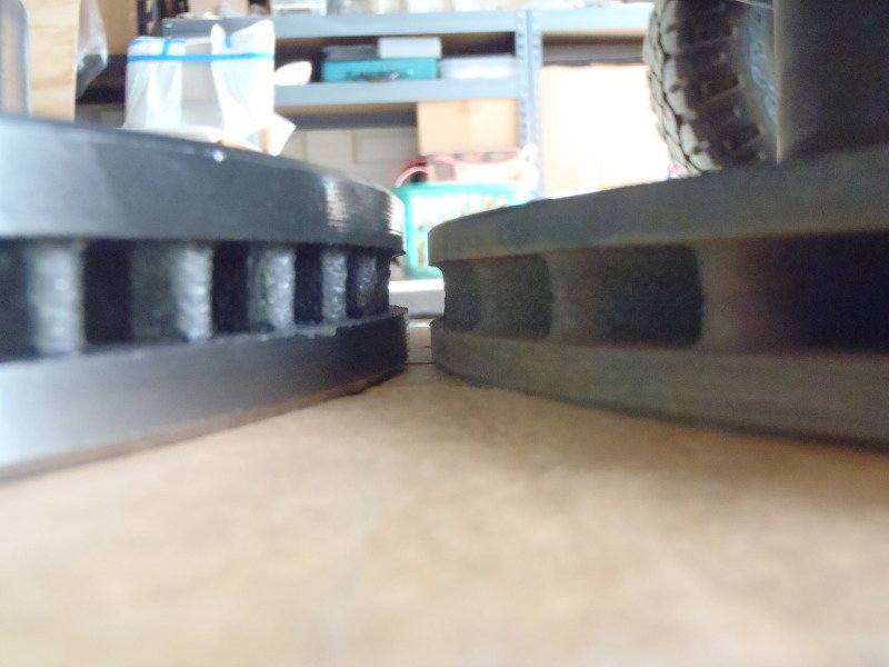

    Tundra brake upgrade. best $350 ever spent..
    Direct bolt on for 1st gen tacos/ 3rd gen 4runner. Just try to warp these beasts, not gonna happen..

    Ok, I just finished reading the tundra brake upgrade and it looks awesome. I am seriously thinking about doing this. I just have to do my rear brakes first then on to my front.
