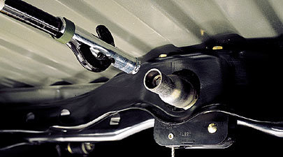

    I managed to take a pic

    Make sure the hook goes into the indent that is in your last picture, then just spin counter clockwise with the tire iron.

    I can't make it out too well in that picture, but it doesn't look like it has a lock on it. That hook should fit right into there, and you should be able to lower the spare just like the guy does in the video above from 2:15-2:45.

    The pic you took of your truck doesn't show that part. So you don't need it. Just put the hook end straight in above the bumper (in the slot) to that part in your pic above. Turn it till it catches in the slot and turn counter clockwise.

    You have everything you need. And from your picture, you do not have the lock. Now the hook extension goes on the very END. This "hook" will act as a large screwdriver... In the middle will be the two straight extensions. And on your end the wrench has a slot to connect perpendicular so you can turn counter-clockwise. This will release tension and lower your spare tire low enough for you to lift the tire and pull the retainer out sideways.
