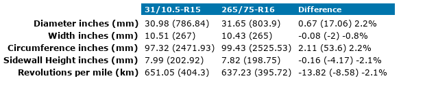

    First gen's came with 31 10.5 R15. They are basically the same size tire. You will be fine

    my '04 had those on it when I got it. Had no problem with them. And I have 16" rims
