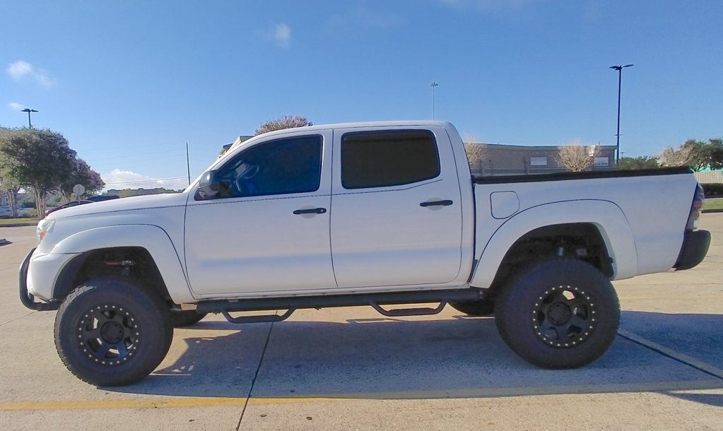

    His photo shows a 2nd gen, but only has a dipstick if it's a 2.7
    Which would be another slug acceleration factor.
    But as I highlighted in post 4, the description of revving up then launch has nothing to do with tires.

    I don't have transmission dispstick. Prerunner 2015 V6 4.0 78000 miles
