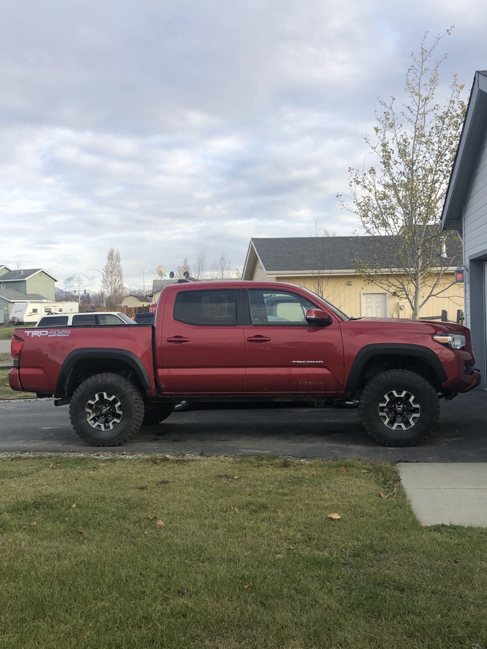

    MBRP Catback 2” Bilstein 5100 lift
    Well, the first thing is... if you can install it yourself or have someone show you you’re gonna be ahead. Dealership quoted me like 1500$ to install a spacer lift (I don’t like working on my own stuff anymore. Lazy.) I spent 780$ on Bilstein 5100’s, 2887 springs, and an add a leaf kit, and an extra cut off wheel I think. Couple hours later I had a quality 2” suspension lift.
    Why 2”? Because I think keeping axle geometry close to stock is more beneficial in the long run on an IFS vehicle. I’ve had a truck on 42” tires before with 7” of lift and it’s a pain to keep up with. Things wear out fast and break.
    255/85/16 fit fine. I got maxxis bighorns because people want stupid money for the same size in other brands.
    I wheel it here in Alaska in stuff that would probably horrify most new truck owners. Does fine.
