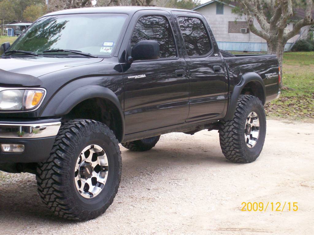

    Tinted Windows, Moto Metal 955's, Cooper 305/70/16 STT's, Deckplate Mod.,AFE Pro Dry, Toytec Coilovers, 2" AAL, Diff. Drop, Bilstein 5100's On the Corners, Alpine 10" Sub, Alpine 305 Head, Polk Mids
    This is my set up. Moto Metal 16"x8", 305/70/16 Cooper STT's, 3" ToyTec Ultimate Kit. I don't know if this helps you at all but at least it's a response.
