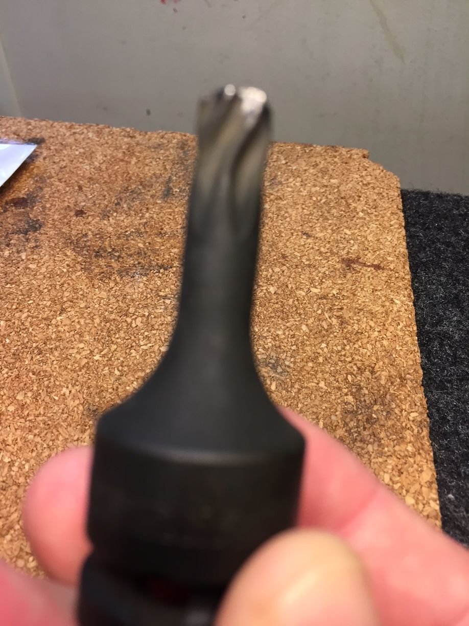

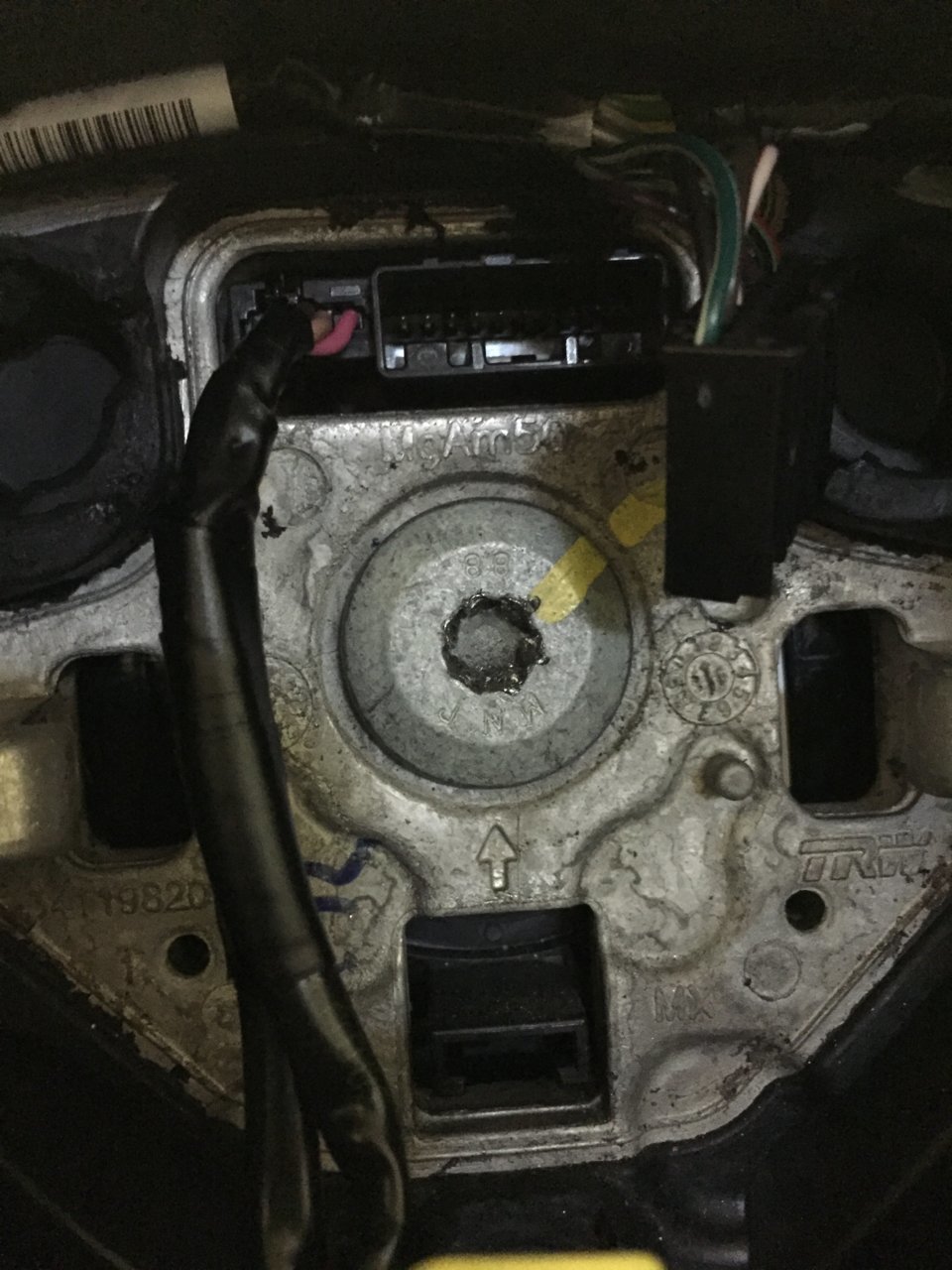

    Always use the highest quality Torx bit available, preferably a Snap-on, as it GREATLY REDUCES your chance of stripping out your bolt like the below.
    Freegolf, shakerhood and wilcam47 like this.
