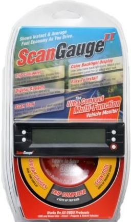

    Get the ScanGauge II on most models it will do Transmission Fluid Temp and water temp, mine I have set up to read actual tire pressure.
    TXpro4X4 and bishgan[OP] like this.

    Thanks for all the tips with the gauges!
