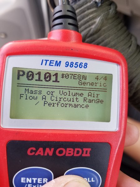

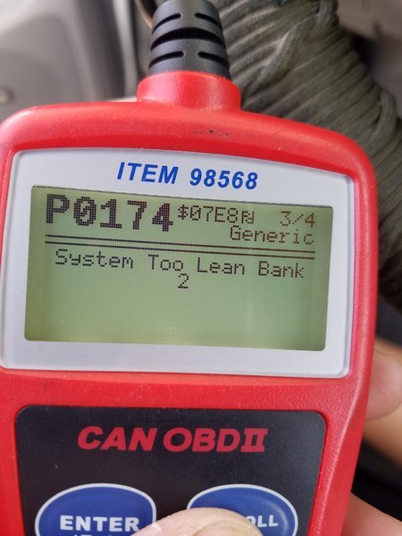

    2012 DCSB 73k, these just popped up. Truck starts to sputter at 20-40mph, cleaned throttle body, cleaned mass air flow sensor with correct spray then changed out sensor. Changed out plugs to brand new OEM plugs, I even gave the gas caps a few extra clicks
