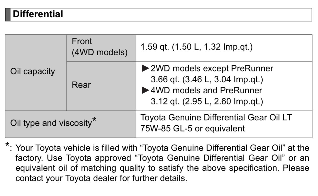

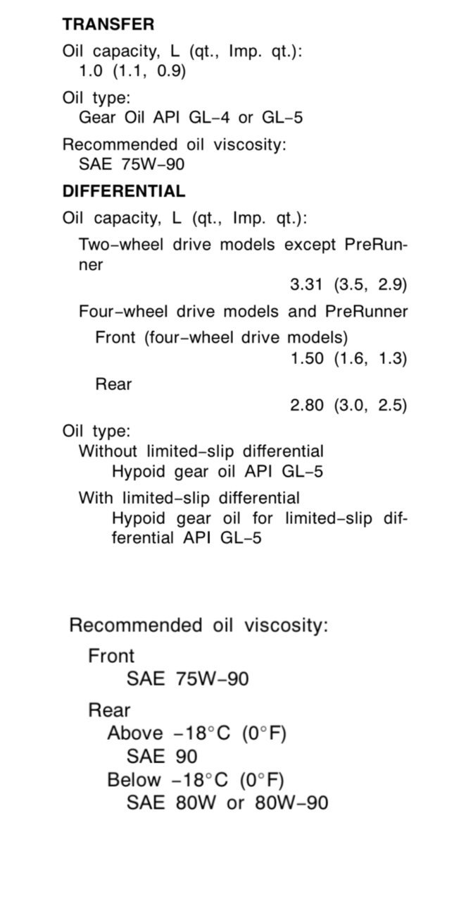

    Weird Toyota changed the fluid viscosity at some point?
    My 07’ say 75w-90 is good for the Front.
    Yet the 2014 calls for 75w-85?
    Anyway, I didn’t run either one in the front diff.
    But did use 75w-90 in the Transfer case. No idea what GL rating. Didn’t even look?

    My 2015 manual actually states GL-5 only for the transfer case.

    My 2011 states GL4 or GL5 for transfer case.
