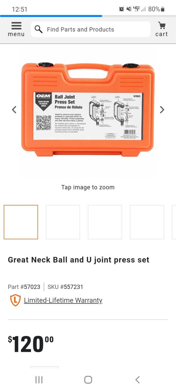

    No Auto Zone, Oreilly, Napa locally? Pay the tool rental deposit and return back within 48 hours and get your deposit back. Litterily free....

    As mentioned above, a C-Clamp is the way to go here. Can rent them for essentially a deposit only or grab one off Amazon for 50 bones or less (I'm sure you'll use it again). Reference this video... you can do it yourself.
