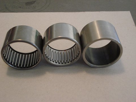

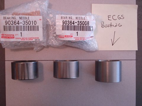

    Negative.... new Nachi bearing has a much stronger needle cage to reduce flexing then the original Koyo bearing. Nachi bearing-steel cage. Koyo bearing-plastic cage

    My bearing had a steel cage :notsure: It looked fine upon removal, even though I had the vibe for over 10k miles.

    Left-original bearing Koyo
    Middle-TSB bearing Nachi
    Right-ECGS
    I have replaced a few and I believe they were all plastic type cages but.... I have never replaced one on a 2012. Only 2014 and 2015 so who knows. I don't believe I have heard of anyone getting the TSB or the ECGS and having the pulsing vibration come back.

    I've been wrong before. I could be wrong about this too. Maybe it's just the sleeve I'm thinking of. I remember looking at the bearings themselves to see of the looked messed up.
