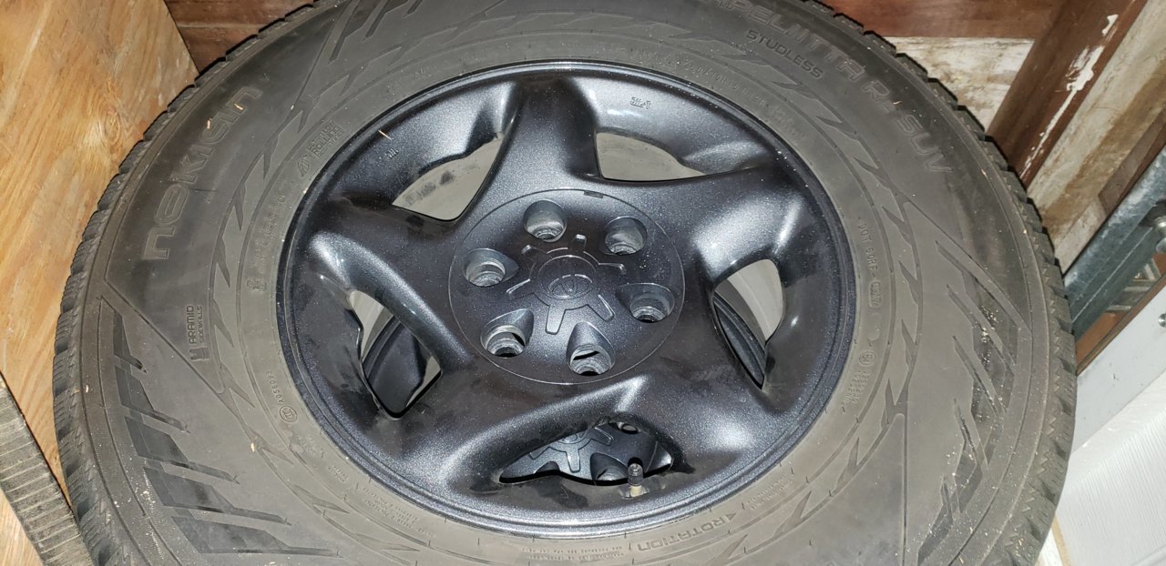

    This was my solution, 2005 Tundra 16" wheels with Nokian winters. $100 off Craigslist. Sand blasted and painted Dark Charcoal Metalic. Good enough for winter use.
