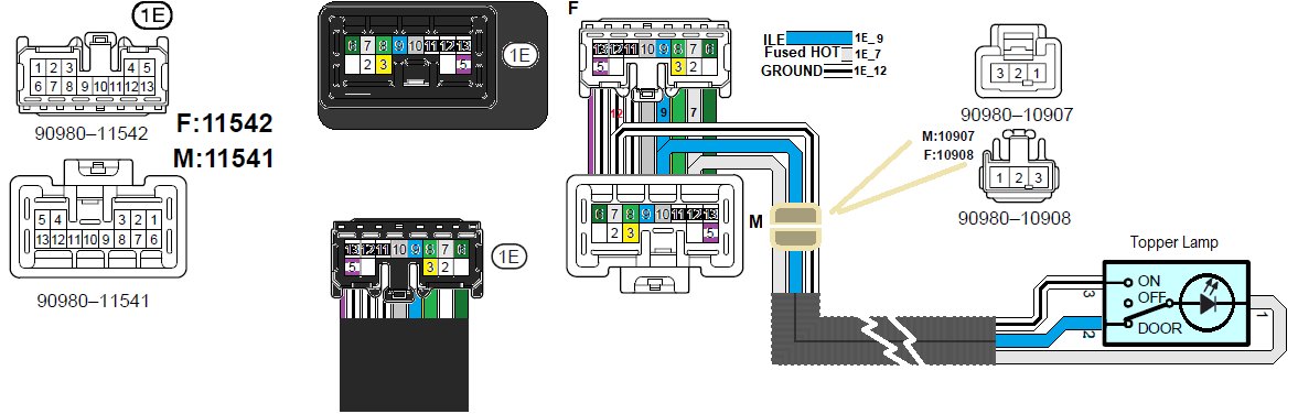

    Welcome to TW! Your gona need unswitched power back there for the light, unless you wanted to use a battery powered one. My canopy actually came with that and it worked good until I ran power from the battery back to the truck bed. You may also be able to tap off the trailer wiring harness if you have a tow package on it.

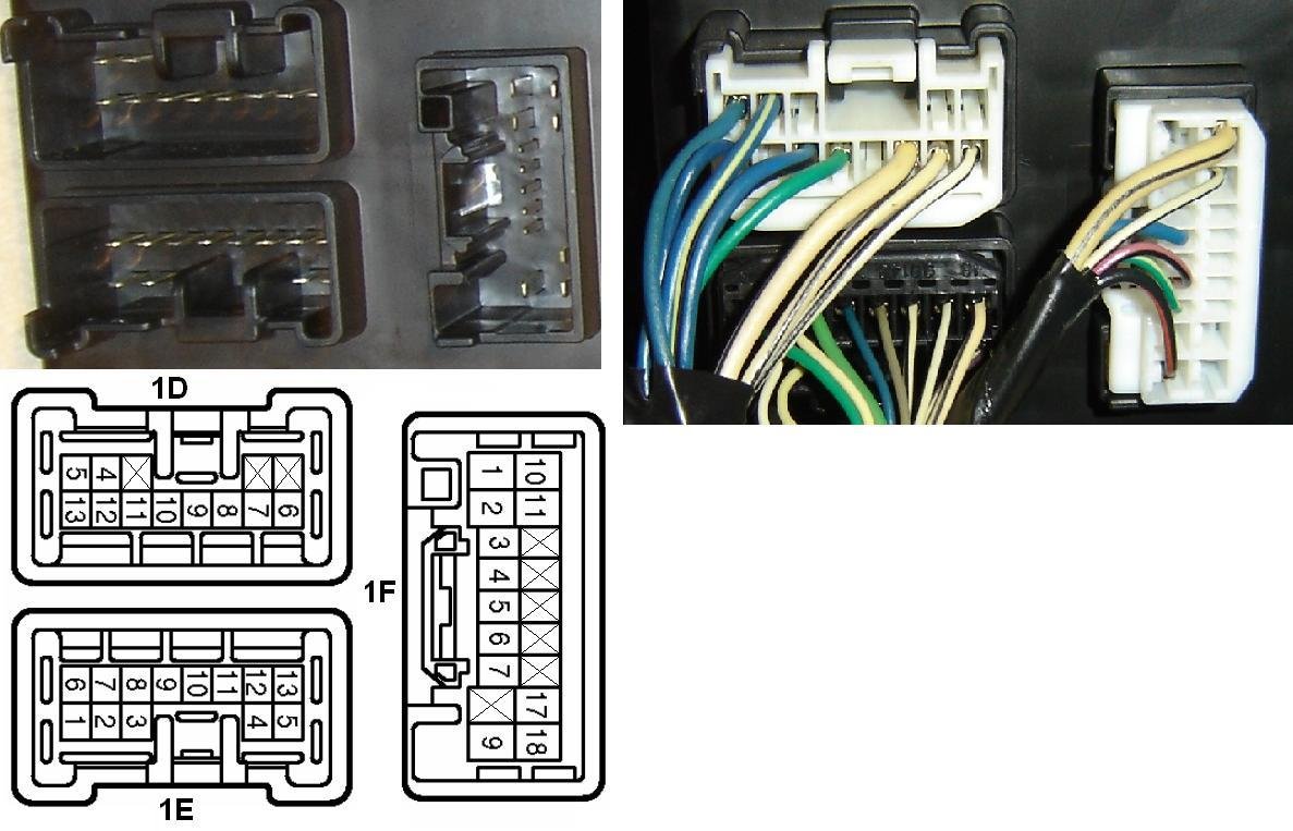

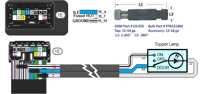

    You could parallel the cab overhead wires to the canopy (long run)

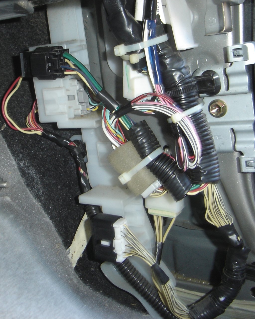

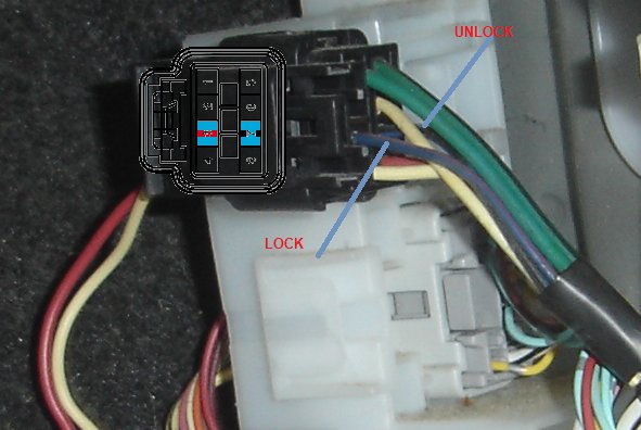

    For the lock, parallel the wires at the kick panel at passenger side, is less cluttered.
    Blue with Black Stripe = UNLOCK
    Blue with Red Stripe = LOCK

    Or this for the Canopy Illumination:
