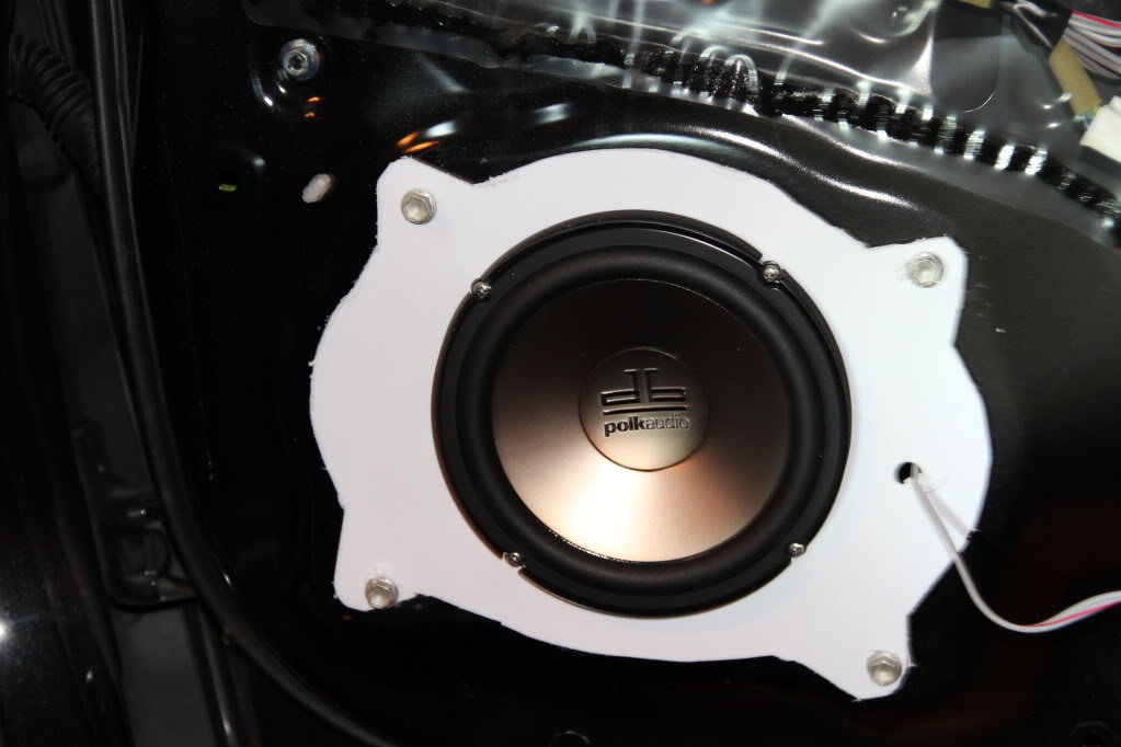

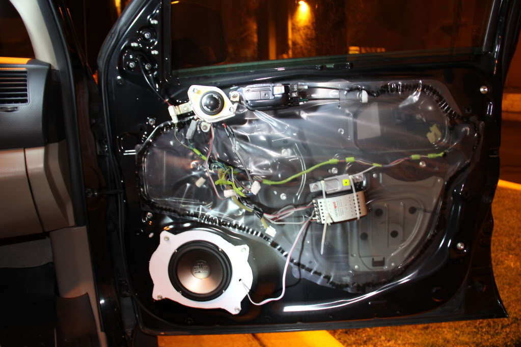

    Nice work. Hope you used some foam or something to keep the crossover from rattling.

    rattle because of the truck or rattle because of the sound vibes?
  6. Feb 14, 2012 at 8:11 AM
    ItalynStylion
    ItalynStylion Sounds Gooooood
    Jun 15, 2009
    #18467
    5,417
    Steven
    DFW, Tx.
    09 Double Cab TRD Sport 4x4
    Could be both. You just don't want them bouncing around on the hard surfaces because you'll hear them buzz. You'd likely have noticed it already if it was going to be an issue so don't worry. If you hear a buzz that's likely what it is.

    going to do any deadening? Are you just powering the component set off the headunit or an actual amp?

    I sinched them down pretty tight, but you are right. I'll pad them when hook up the amp.
    They are powered of my headunit for now. I am going to deaden the doors when I hook up the 4 channel.

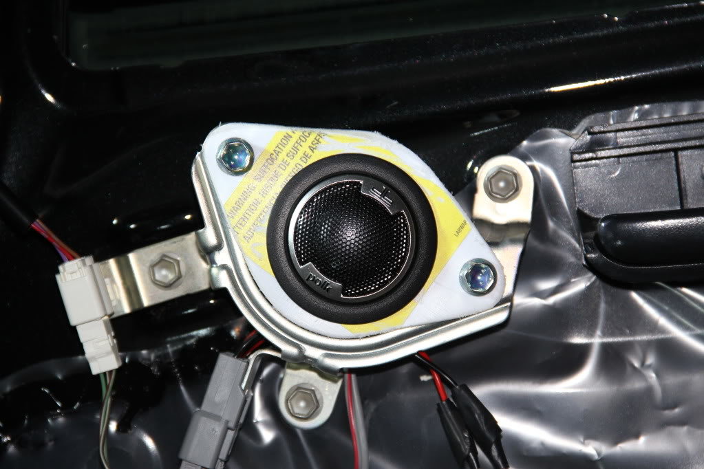

    Props to the OP for a job well done... It's great to have someone that can figure things out on their own and come up with good results.
    I can't tell what you used for the speaker/tweeter mounting plates - it doesn't look like any sort of a wood product I've seen before, in fact it almost looks like some sort of a plastic?

    you don't wanna know :D

    Cutting board?

    It looks somewhat "fiberous" around the edges... that's why I said plastic, and it doesn't look more than 1/4" thick either

    Yep it's plastic alright, I used the lid from one of these. It was really big and perfectly flat.... used the stockers for templates.

    Way to be inventive on the baffles, but you'll really wanna get some MDF or something to replace them with asap... I mean a 2'x4' piece of 1/2" at Home Depot is something like $5 in my neighborhood. Don't forget to seal them up too... rubberized undercoating or something

    The plastic will work fine until the doors are deadened and the speakers are amped up. Ith's a temporary fix. :p

    good question... I was looking for one but they were all too thick and seemed hard to cut LOL

    That is one of the things that makes them great for a baffle.
    The sub is probably worth it, if you want to build a box for it. I would use a cutting board over a MDF baffle because of ease and no need to worry about sealing or water proofing it.
