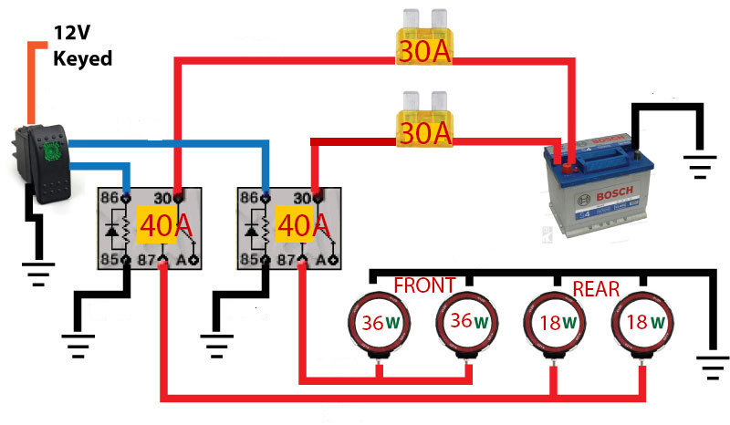

    So I'm going to run some led bars in the front and rear. Mostly just for putting the boat in and out of the water at dawn/dusk so I don't need a huge light bar. The front is going to have two 36w 8" bars, and the rear two 18w 7" bars. My plan is to buy this harness which has two leads and run one to the front and run one to the back. I would double off each lead since I think both lights are small enough wattage. I drew a little diagram. What do you guys think? Should I lower the fuses? The kit comes with 30a but I don't think I need that much.Tacoma.jpg Thanks for your help.

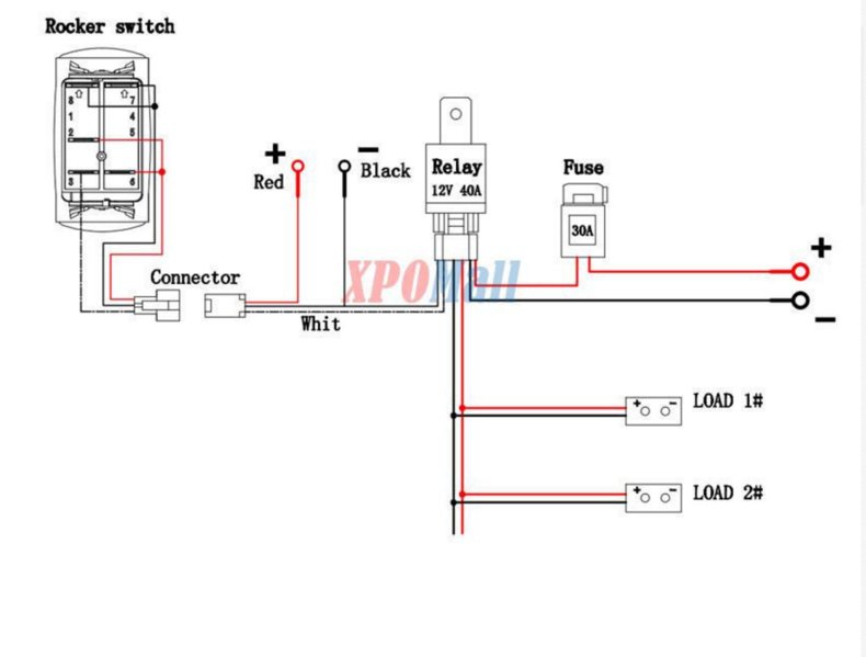

    Looks good if not a bit overkill. A pair of those lights is 72watt = 6amp at 12v here's a converter calculator. You can also run all 4 on one relay, if judging by your diagram that you want them all on with the same switch. Good practice to have the switch powered by the ignition power so they turn off when the trucks not on.

    I just checked the diagram for the link he posted, and just generally knowing these setups but no power is fed from the relay to the switch. The switch feeds power to the coil side of the relay. A lot of times the same battery power lead is jumpered to the switch and relay, meaning the harness will be hot all the time.

    Here is the Diagram with some notes added.

    I guess I should have worded it differently... but I agree with the input power for the switch is generally ran from the fused battery wire at the relay making it "hot" all the time. Both wires are crimped into the same terminal connector. This is what i meant in the first place.
    Rigid, Piaa and various other harnesses are typically done this way.

    For those lamps the boat switch you are showing will handle the amps without a relay. If it's an On-Off-On (dpdt) then you could also handle the lamps as rear only or both on.

    Why are you putting them both on 1 switch? I would have 2 separate circuits. If you are using the lights in front to see where your driving you dont want to blind people behind you. If you are using the ones on the back as back up lights as you back into the water, no need to blind other people up higher on the boat ramp waiting there turn.

    Maybe while the truck is getting to the ramp, leaving the ramp or even preparing the boat at dawn, dusk or night he could use all light available...

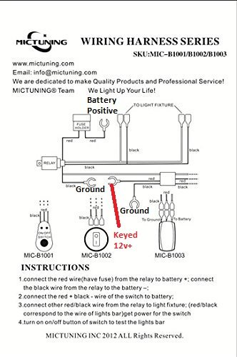

    These lights are just for prepping the boat and unloading gear in the morning to go hunting. Got my harness. Do you think I can put both the positive and negatives on one ring terminal connector and connect to the battery?
