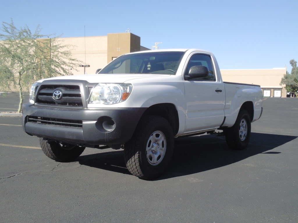

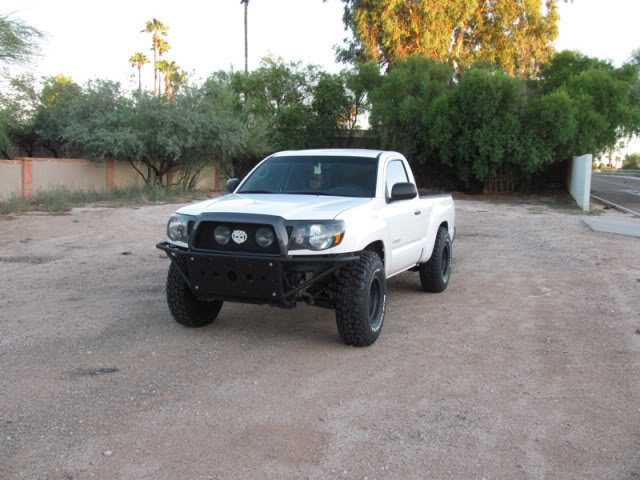

    Readylift and Fat Bob's garage make top-plate spacer lifts for 5-lugs.
    These two truck have those kits:
    08whitetaco:
    neslerrah:
