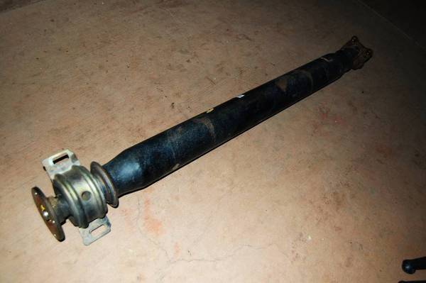

    Grab the drive shaft and make sure the center bearing does not have excessive play side to side. [​IMG][​IMG]

    I hear the noise making both left and right on the pavement. its not when im stopped but moving and not at full lock. my truck has 165xxx miles and no mods. i am going to check the carrier bearing.
