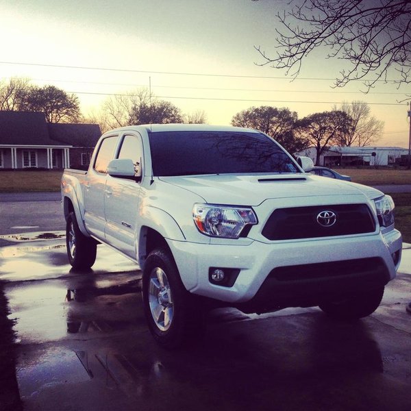

    Can't seem to figure out what lift to go with, want a 3 inch lift but I also don't want to empty my wallet. Seen eBay sells some but really don't want to lose my stock ride.. Anybody has and ideas or answers?

    well, i would have to tell ya to stay away from spacers if you want to keep your ride quality. i say look into blistein (probably spelled wrong)5100's up front and an AAL in the rear. look at the Toytec website OME makes a 3 " that isnt to outrageous. hope that helps either way keeping stock ride quality and getting 3 inches of lift is going to run you around 600$

    Use the "search" function and you'll find plenty of info. Also, try to be more specific when you choose a thread name. Some people get butthurt when you post vague things like "help!" Try "new guy has questions about lift"
    But, blistein 5100's are always a good choice!
