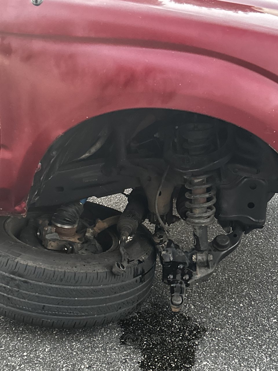

    Hi, Any suggestions on what I should do or should I just sell it and find a new Tacoma . My mom was driving it hit a speed bump and axle ball joint just broke

    Ouch; known issue...lower ball joint failure. Due to the design, it is strongly suggested that you only use a quality lower ball joint. Not only that, it's strongly suggested to replace them at a normal interval of 100k miles (road driving). Some people replace them every 50k miles (they offroad though).
    Get the truck home.
    Replace the lower ball joint and bolts with OEM parts.
    Pull your CV axle, DO NOT GIVE IT UP AS A CORE, and buy a parts store variant as a temporary solution while you reboot the OEM one you pulled.
    New tie rod end.
    Easy fixes really.

    If the truck still runs good, fix it.
    It happens, you aren’t the first.
    It’s a “weak” point on the 1st gens.
    Fix her up, and carry on!:thumbsup:

    I saw this happen to a 4runner. He just made a left turn and pop goes the weasel.

    If you have the skills and tools to fix this go for it.
    What kind of shape is the rest of the truck in?
    Paying labor for this job can be expensive.

    It seems like it mostly happens at low speeds, like pulling into a parking lot or something like that. I’ve never seen one that failed at highway speeds. I read somewhere that they’re under more stress at lower speeds.

    Thanks for the reply. I never knew that I Learn something new. Sucks cause I’m not in my home town right now I’m in vacation but my brother and mom was able tow it to my mechanic house. I order all the parts already. Keep you updated once I fix it
