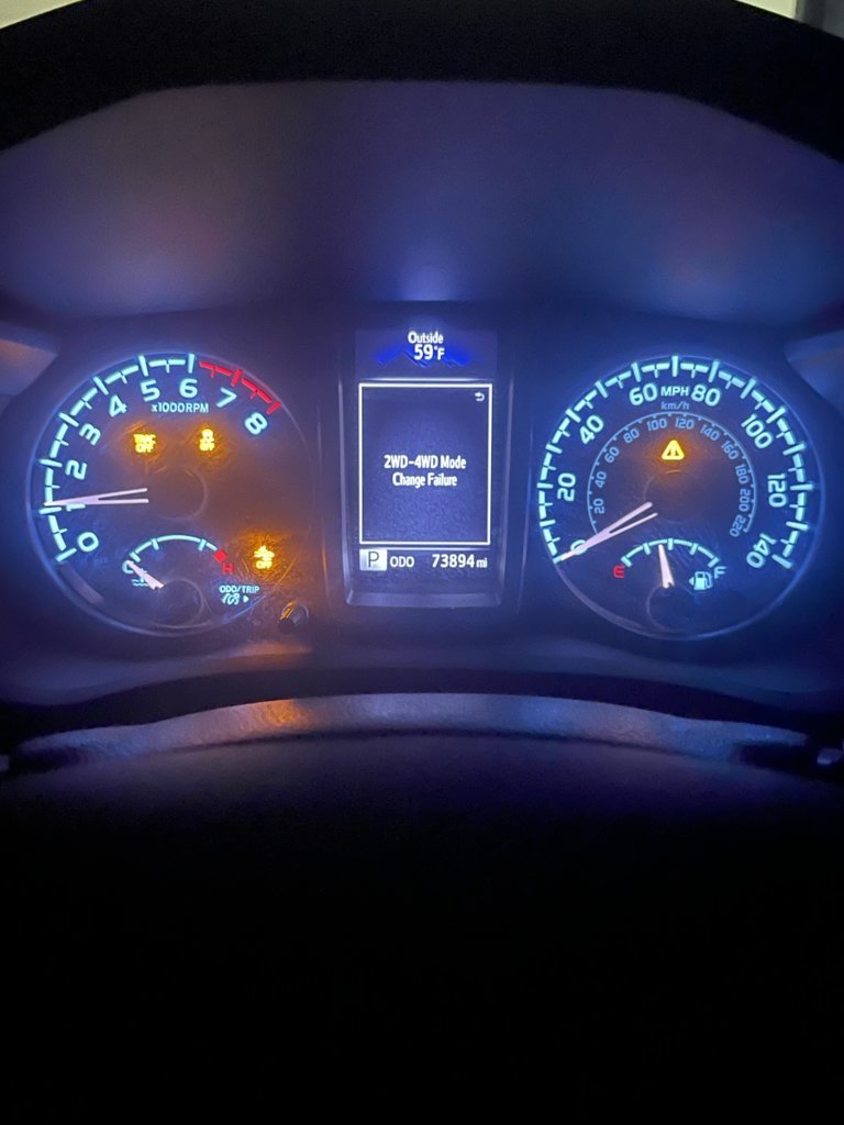

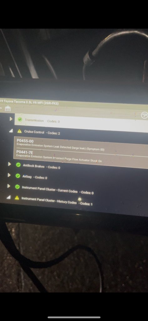

    I need help with these codes, I know the evap ones are for my Napa gas lock because someone put something in my gas tank so that’s for now, I got a bunch of codes on my truck…

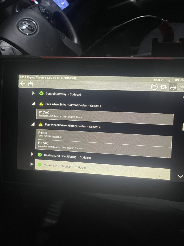

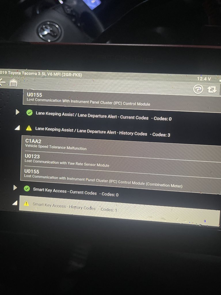

    The shop I went to cleared it and these were the main codes.

    Solder front oem actuator, code still on, threw away oem actuator. Put on Amazon actuator, code still on. Looked at transfer case actuator and nothing looks bad but got those codes, can it be needing a new transfer case actuator?

    I went to a shop to diagnose what were all the codes was for.

    I guess you had the codes before you changed out the OEM actuator with a Amazon “replacement” .. hummm. Are you sure the wires were reconnected properly? Do you exercise the 4 wd monthly? I’d try the negative battery cable first then I would buy an OEM part. My rule of thumb is always purchase OEM specialized parts from the dealer. Costs more but I don’t get codes when repairing or replacing. Even spark plugs, I’ve read that some are not within spec from some sellers on Amazon.
