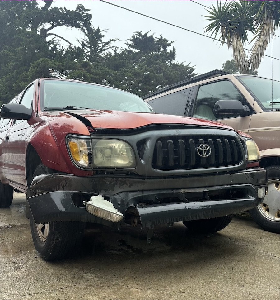

    It has 170,000 miles and has never been in an accident...until now!
    I got into a fender bender on my passenger side. It drove away from the accident just fine so I assumed only the body needed repairs and took it to body shops for quotes, but not a mechanic. The frame is fine, but the apron and radiator support are bent so it will be taking a ride on a frame machine.
    It has been sitting sad and injured on the curb for the past 3 months while I have been scouring the internet for used oem parts. I am finally ready to take it to the body shop, so yesterday I drove it around my neighborhood. The first thing I noticed when I started the engine was a loud blowing sound. Not sharp like an air compressor, deeper like a large fan.
    Or maybe the RPM is just idling high and I'm mistaking it for a blowing noise. When driving the engine began revving rhythmically. It is especially loud in idle, but not as noticeable when I reached 3rd gear.
