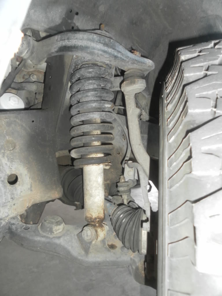

    Looks like you need a diff drop too… that thing us lifted no way it's stock look at those cv angles.

    x2 your CV angles look horrible :eek:

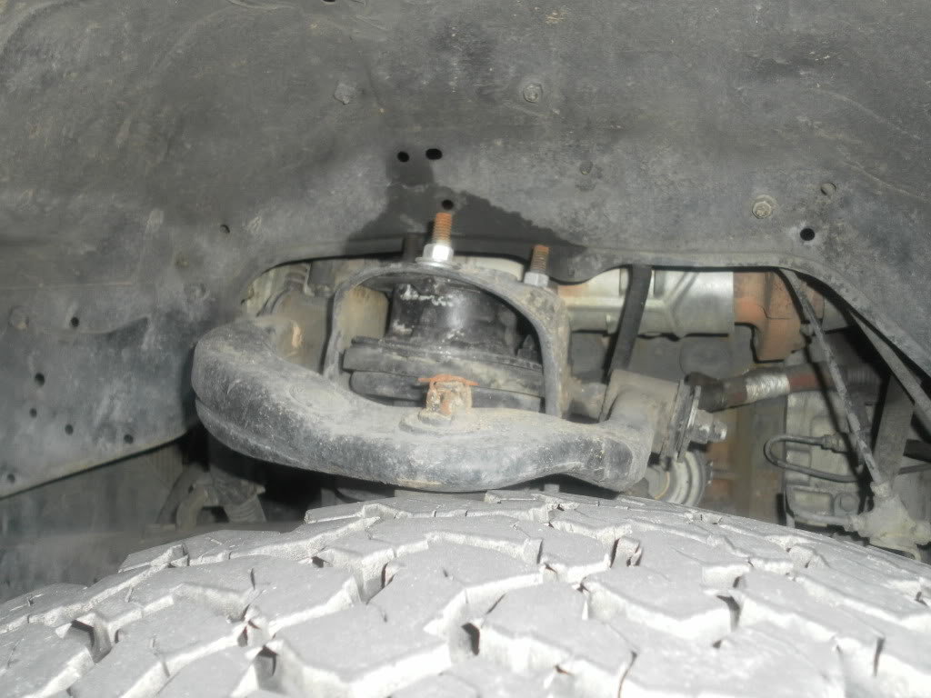

    I don't see a coil spacers so you must have a top-plate spacer...? Hard to tell from the pic.

    the upper arm is on the way... let get another one

    lets see if this helps :D :$SAM_2665_bc40ccbad67e3e7dfbcc42886e1ad02c9aced909.jpg

    Confirmed. It is a top plate spacer. It lengthens the shock assembly to achieve lift.

    I would start with a diff drop before I changed anything else. Your CV angles are in bad shape.
