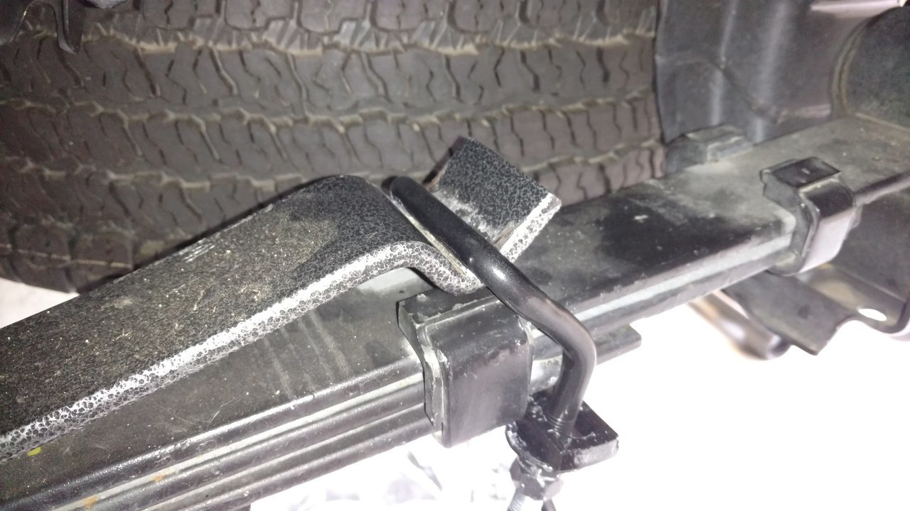

    I'll take pics tomorrow. I had a small issue with the installation of the Hellwig 980's....the rear ubolts didn't have enough bend. I called Hellwig and they are sending me a new set of ubolts with more bend. For some reason there is a small difference on SOME of the 2017 Tacoma spring keepers. I'm really picky about the ride of my truck. The Hellwigs brought my rear end sag back to original stock with the camper....you lose 1/2" with the camper shell. The Hellwigs brought it back up and they aren't even tightened down all the way; they are adjustable.

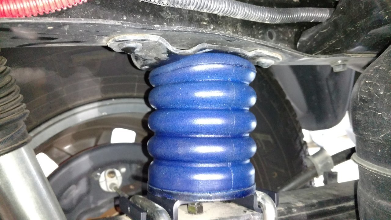

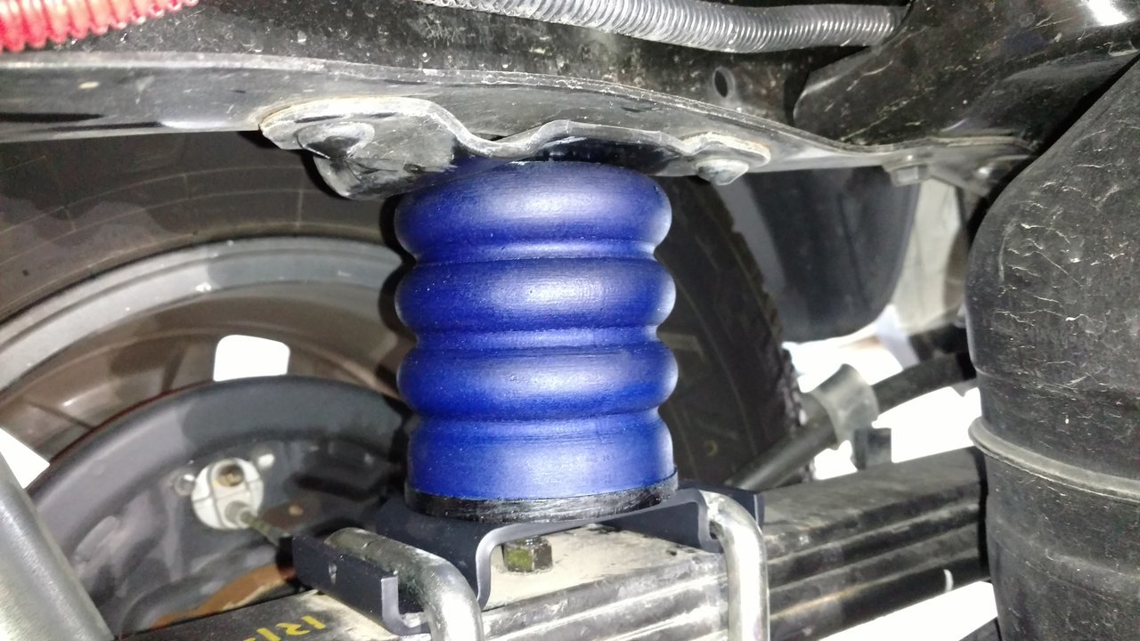

    SUMO SPRINGS - I have a lot of information on these springs. I did extensive testing and measurements with the sumo springs and spoke to the president and CEO of Sumo Springs several times.
    1st - the SSR 610-40'S that they send you are too big especially if you have a camper shell; they have 5 doughnuts. The weight of the camper shell does not allow for the correct amount of gap between the sumo springs and the frame plus they are too wide (see pics). The bottom line is they produce a rougher ride than intended. I experienced bouncing from the sumo springs even the shorter second pair that they sent me. It's as if they don't let the shock absorbers do their job. The rebound is forced upwards from the compression or skwish when you encounter a bump. The shorter pair (have 4 doughnuts) have a slightly better empty ride but they still had the same ride when loaded. I was still going to have cut the shorter pair 1/2" to get the correct air gap with the camper. I even took the camper and took measurements loaded and unloaded.
    #2 - the original pair actually raised the truck 1/4" above stock even with the camper on. The springs were too tall and it made the ride even worse; especially if you have a camper. If you hit a good size bump...they will kick back pretty hard.

    My new ubolts haven't arrived yet....but it will be worth the wait. Here is what it looks like so far. I'll send another pic when the new ubolts arrive. BTW I lifted the front Bilstein shocks to #2 which is .65" . My driveway is uphill just a tad.

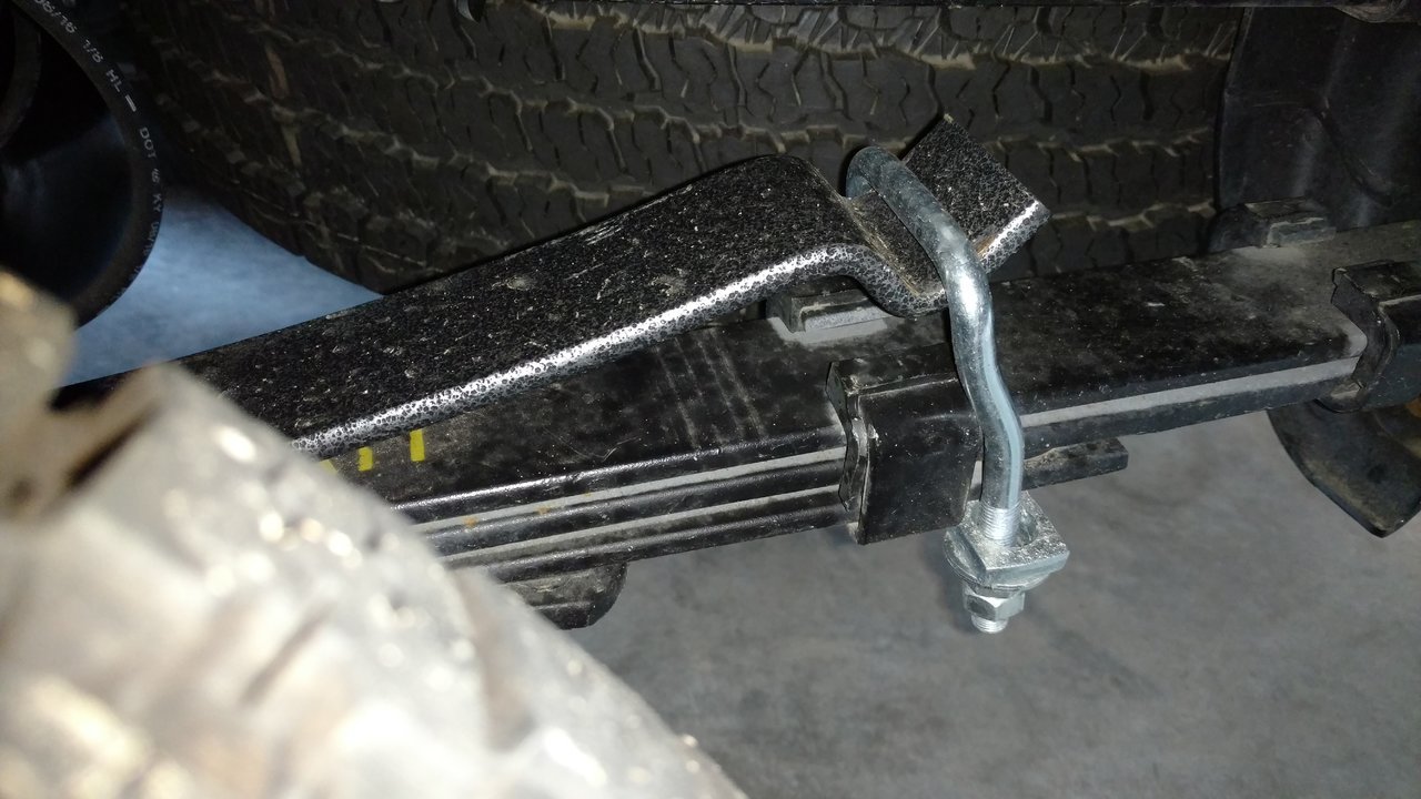

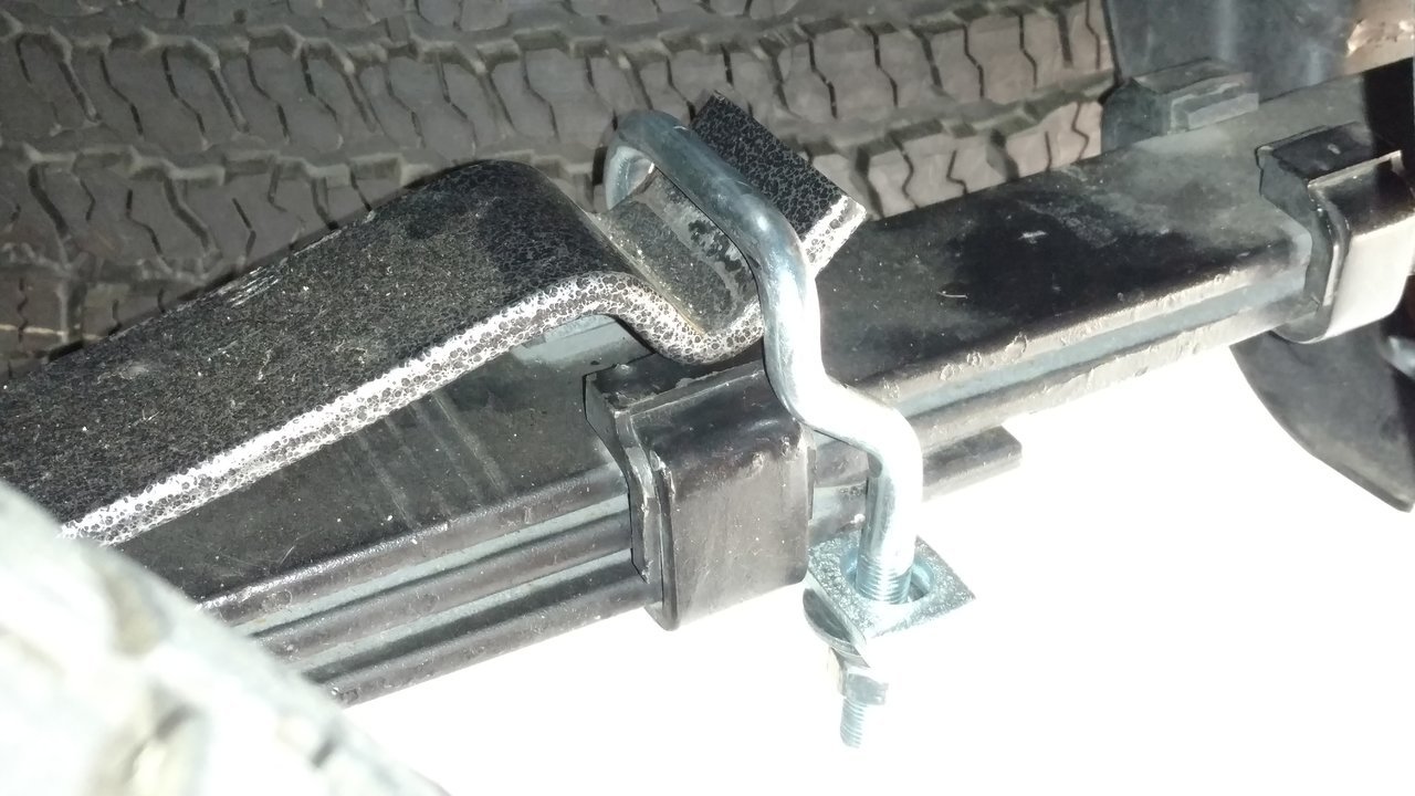

    The second set arrived last Thursday. I emailed them the pics of the new ubolts. They didn't test fit them before they sent them to me. Got a reply today that they shipped a third set of ubolts that they test fitted on a 2017 Tacoma. Hopefully they will arrive by Friday or Saturday. I attached pics. I actually took the second set of ubolts and bent then myself with a bench vise and an Acetylene torch. They worked better. I'll send pics of the newest bolts when they artive. I'm still very happy with the 980's. Hellwig is going to update the hardware packet for the Tacoma....you may have to call their tech line to get the most recent ubolts.
