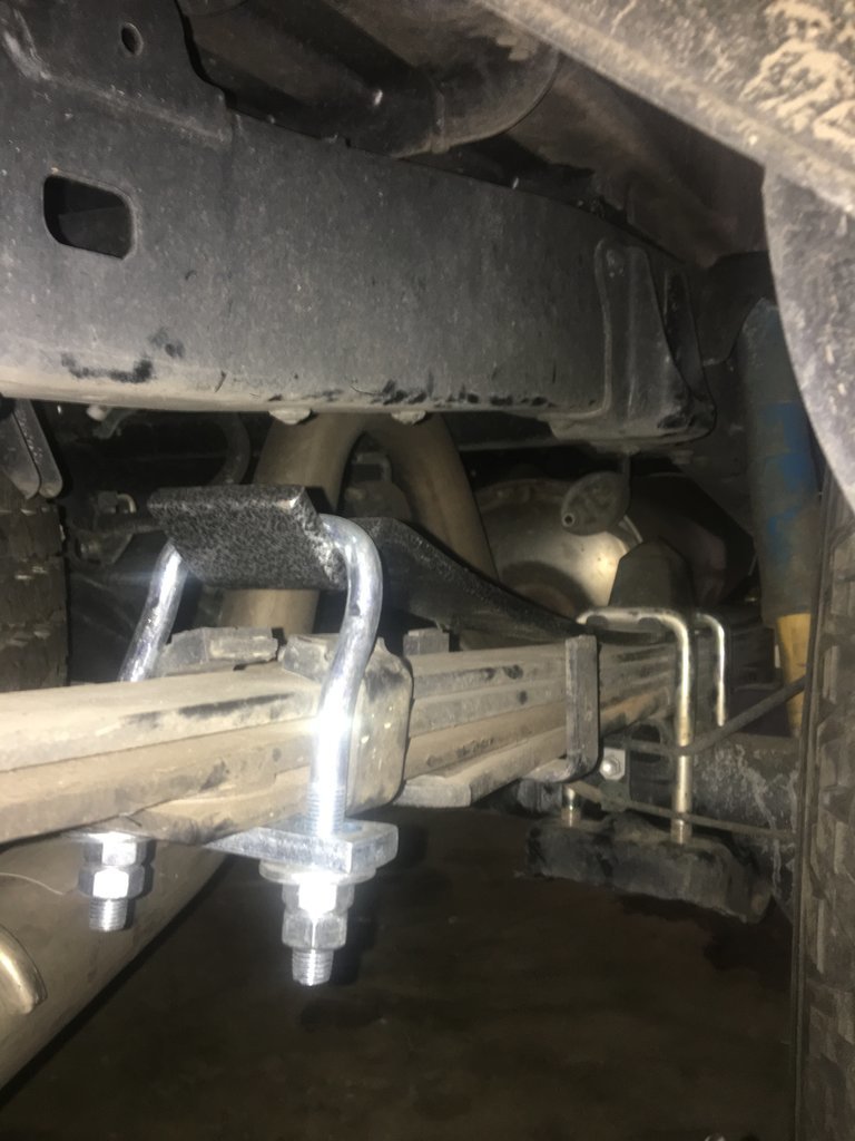

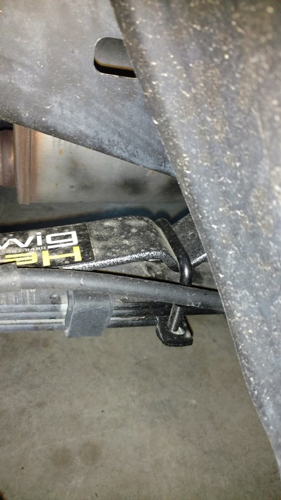

    I can take a pic this afternoon.
    The ubolt on the driver side is right next to the gas tank, that ubolt mounts sideways with the torque nuts facing outwards. The passenger front mounts just like the rear ubolts. Since the front mounts are different with no adjustment on the driver's side, I measured the distance of the driver's side and applied that measurement to the front passenger side so the two Springs would have the same amount of tension.
    Remember the more you tighten down the ubolts in the rear the softer the ride; the more arch in the spring the stiffer the ride.

    Thanks appreciate it.:thumbsup:

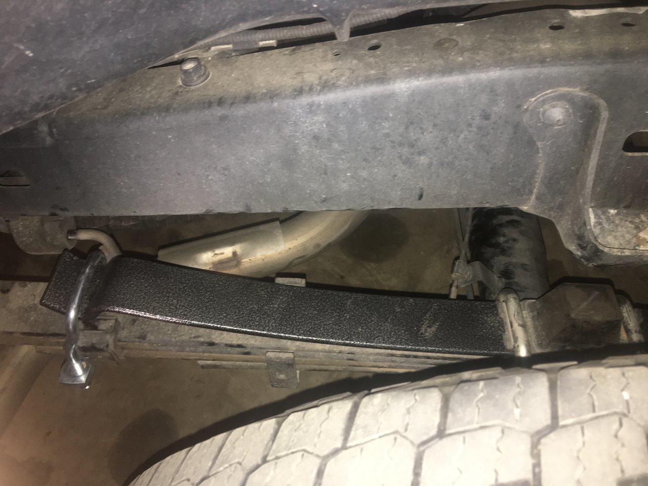

    Sorry it took a while...had to mow 3 yards. BTW...I painted mine black

    No problem . Live in Hawaii so still early for me lol... Looks like going to work on mine . Coming in on Monday .
    Thanks for pics.

    My updated ubolts arrived this afternoon. I am super happy with Hellwig's customer service and the 980's I purchased! The first and second set of ubolts didn't fit right with the factory spring keeper. These give me exactly what I wanted without affecting my ride quality loaded or unloaded.

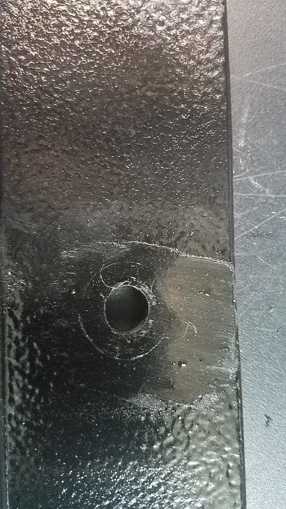

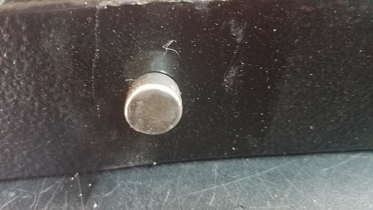

    Installed today . Works with tundra racing drop kit . Got 2013 tsb springs and seems a little different . Had to install passenger side front u bolts side ways like drivers side because 3rd leaf end is to close to spring clamp. Need to order that u bolt .
    Thanks Taco351 for pics and info:thumbsup:
    For anyone with TR kit
    Actually got a little arc back and to me ride feels a little softer over bumps . Will test some weight latter.
    Also had to make a spacer to go in helper spring center hole cause was to big .Also needed new centering pin so could center into TR axle perch.

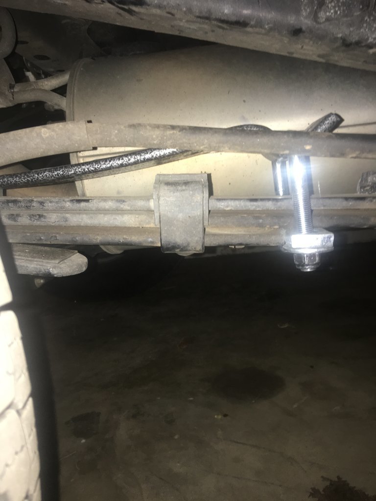

    I have an 08 TRD with the recall packs. Localish Toyota dealer preformed the recall 2 months ago. I have done virtually 0 off roadin since then, as I pretty much worked the whole time and had 2 different work trucks. I just built a sleeping platform in the back and have a shell so wanted to offset the weight.
    Got them through suspensionconnection.com the hellwig 979 is what was recommended. A note said to get the 980 if you have the recall leaf pack. Im finding several different sets of instructions to put these on. I have them mounted long end forward now and I'm at the point where I have to cut off my exhaust to make the rear U bolts fit. (By the way half of the axle u bolt nuts were fingertight from the dealership. Glad I haven't been doing any off-roading...)
    Before I cut off the exhaust I want to make sure that these are correct and mounted correctly, obviously. The pictures that I have seen of the u-bolt mounting positions look very different from where mine will be. I will post pictures here, looking for suggestions / confirmation. Thanks
    both of these pictures are passenger side, driver side looks identical concerning the relation of the new u-bolts to the leaf spring keeper clips . 1503187571808-1597224577.jpg 1503187667342-1749473331.jpg

    2015 Silver Sky TRD OR DC 4x4
    Your recall springs look different than my 3rd gen. Not really sure what the answer is.
