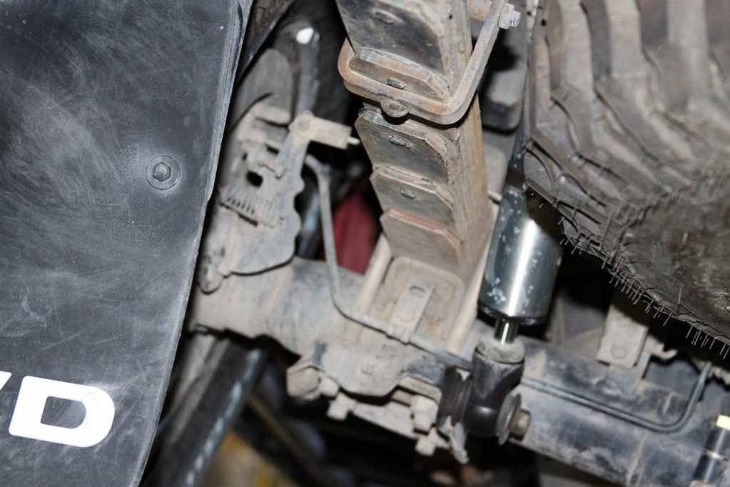

    OP, this VVV is sound advice. Do this before you buy your shocks.
    If you have access to a forklift like I did, put your spring pack on and flex it out.
