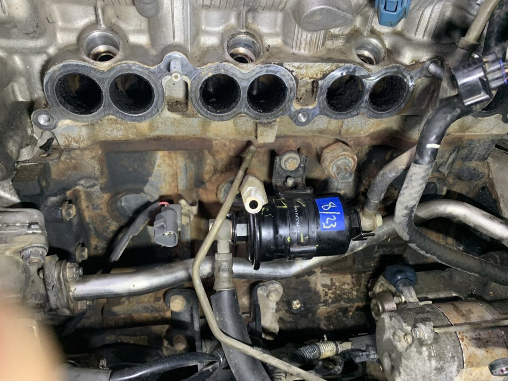

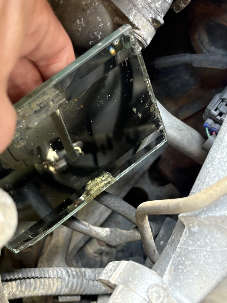

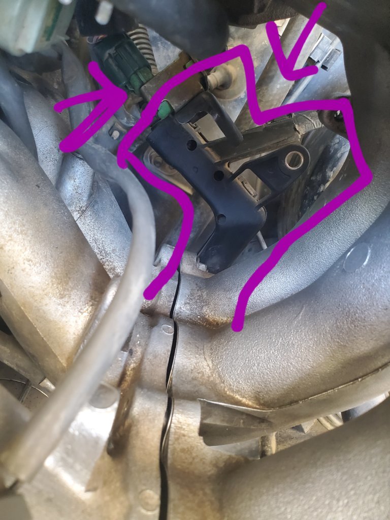

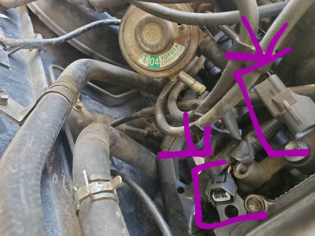

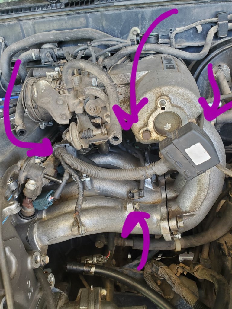

    Sooo just did a head gasket job, took the whole intake manifold out, unhooked unplugged everything. I was counting on help from a more experienced mechanic who bailed, now im putting everything back together and trying to figure out where it all goes.
    Anybody have detailed photos or diagrams? Its been difficult to find anything helpful on the internet. I think ive got some stuff in the right place, but the diagnostic box doesnt quite reach where its supposed to go etc. Something is funky and there are errant plugs and brackets all over.
    Any and all help appreciated

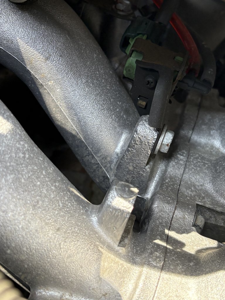

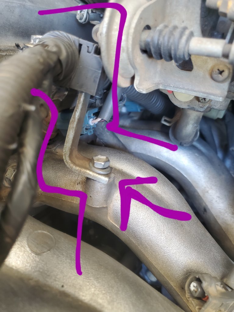

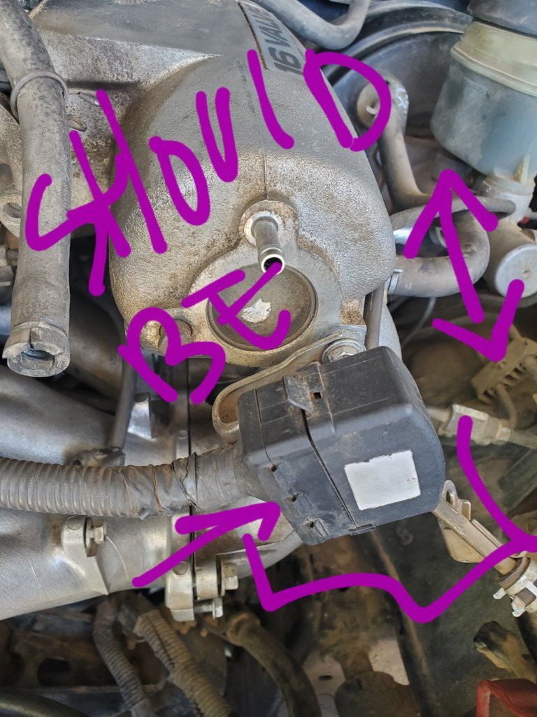

    There are more plugs, but difficult to capture on camera20250609_104321.jpg 20250609_104303.jpg 20250609_104105.jpg 20250609_104049.jpg 20250609_104041.jpg 20250609_104039.jpg 20250609_103843.jpg 20250609_103837.jpg

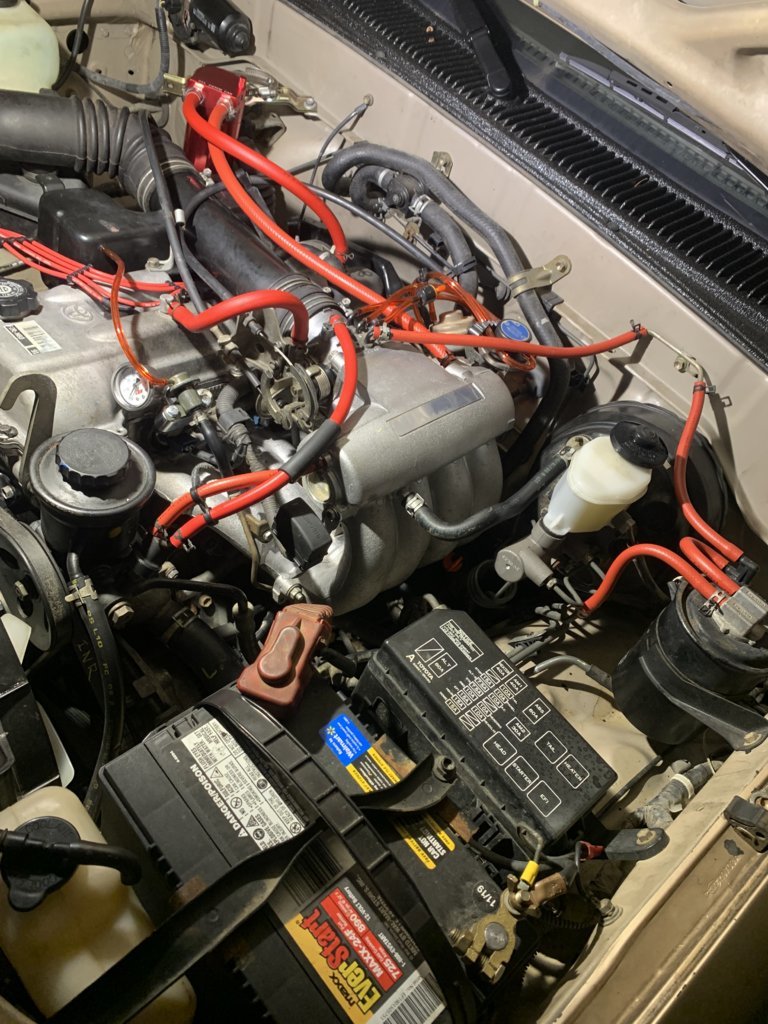

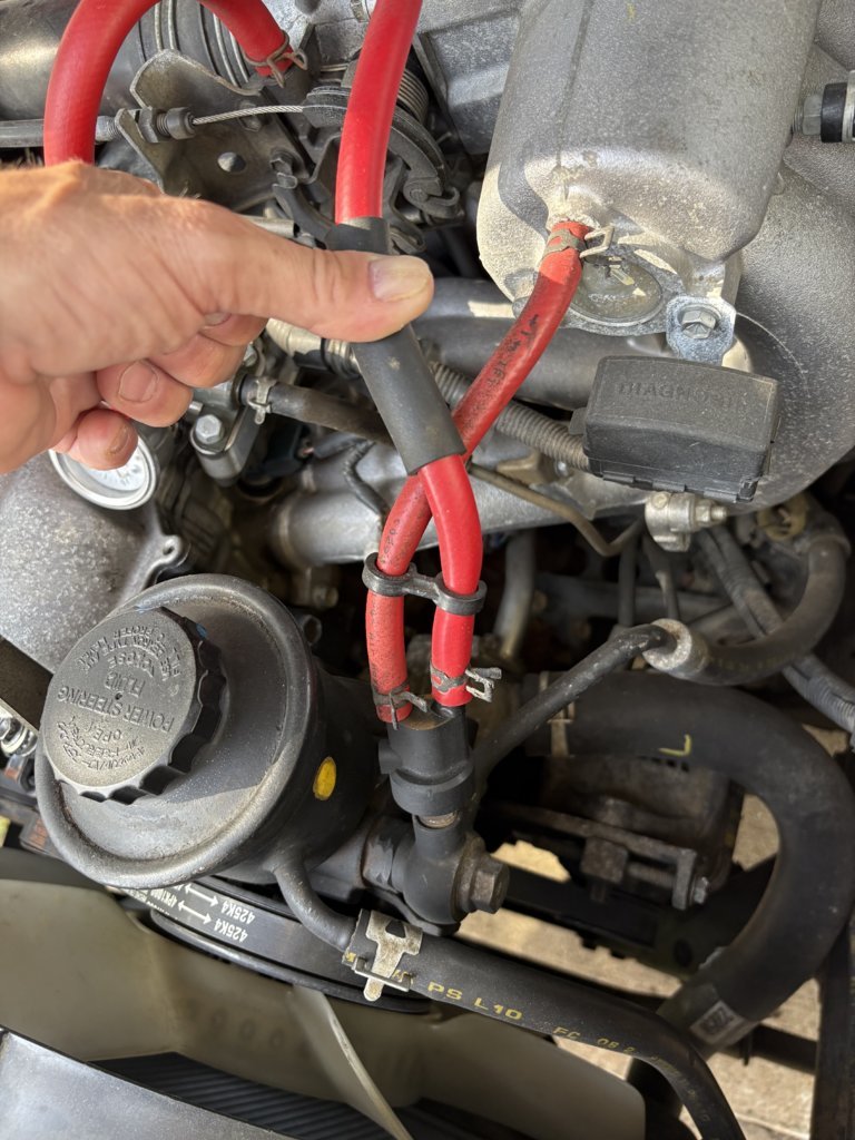

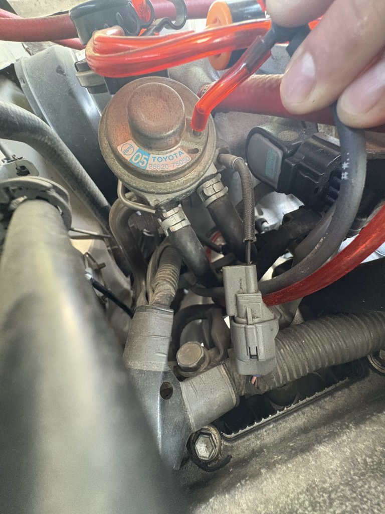

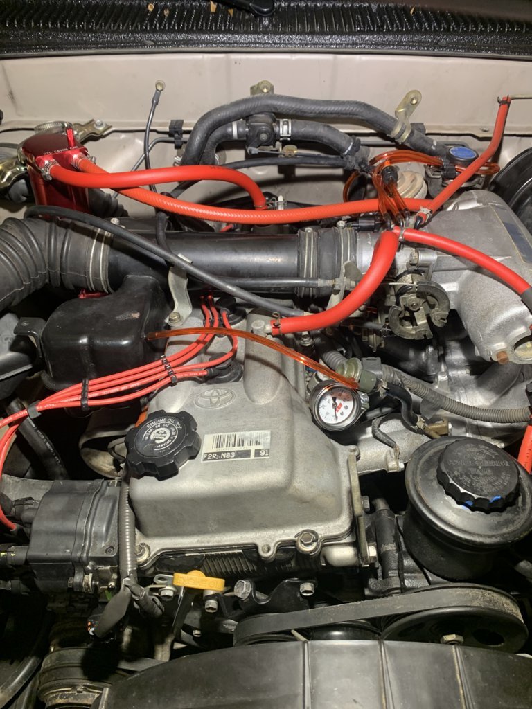

    This will get u started
    1996 2RZ after intake/plenum reassembled

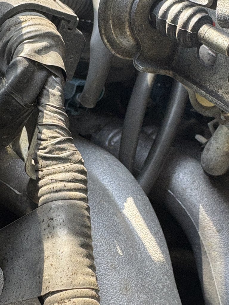

    IIRC
    There are 3 pigtails hidden under intake
    t0p_d0g likes this.

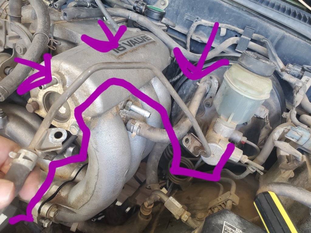

    @ControlCar thank you!! Where does that loose pipe w two small brackets for individual screws go???

    Also only seeling two plugs ??

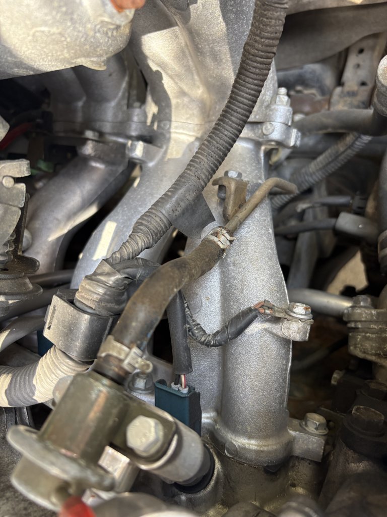

    think that is fuel return line one side goes to FPR.....
    i will get better pix when i get home for you

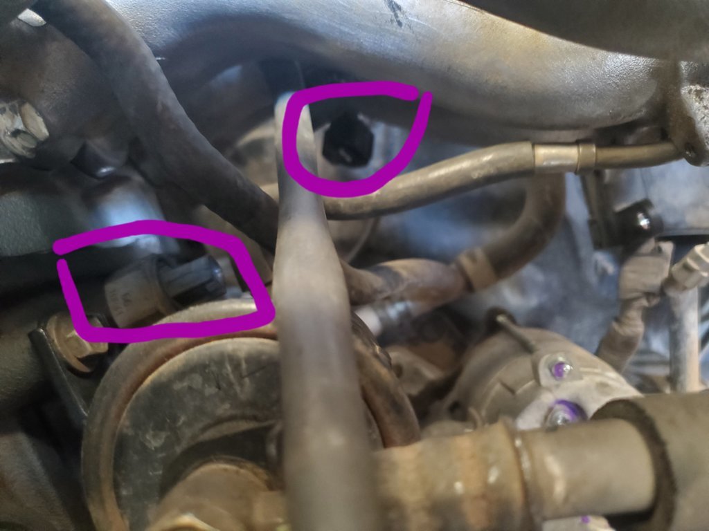

    one plug sits on top of the plenum and under the intake a solenoid
    like inside the 'tunnel' space closer to the rear

    Here some more pix

    That hard line…..
    Fuel return line

    This is the solenoid inside the intake tunnel

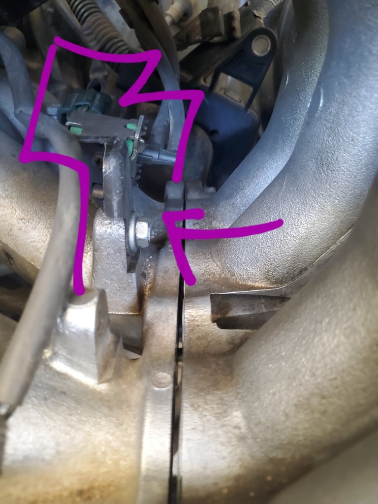

    It’s all coming back to me……..
    so there are 2 harness connections that need to be placed in between the gaps in the intake
  15. Jun 9, 2025 at 2:54 PM
    ControlCar
    ControlCar My Moto: Help & Learn…period.
    Jul 22, 2023
    #429578
    3,330
    Steven
    Sugar Land TX
    1996 Taco 2.4L 2wd Automatic
    Clock Volt meter/LSPV Delete/Hyundai 16’s/FP gauge/after 9months of wrenching ZERO oil leaks
    On mine
    They go to TB

    Again
    This is from my taco
    Yours might be lil different
    Andy’s advice is spot on
    GL

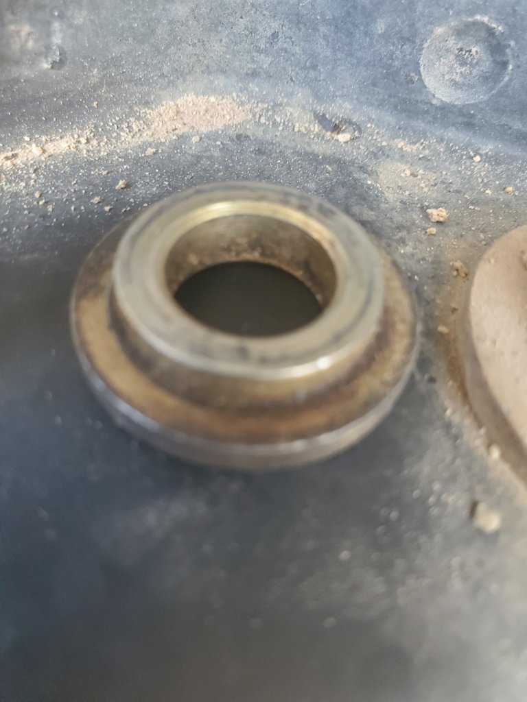

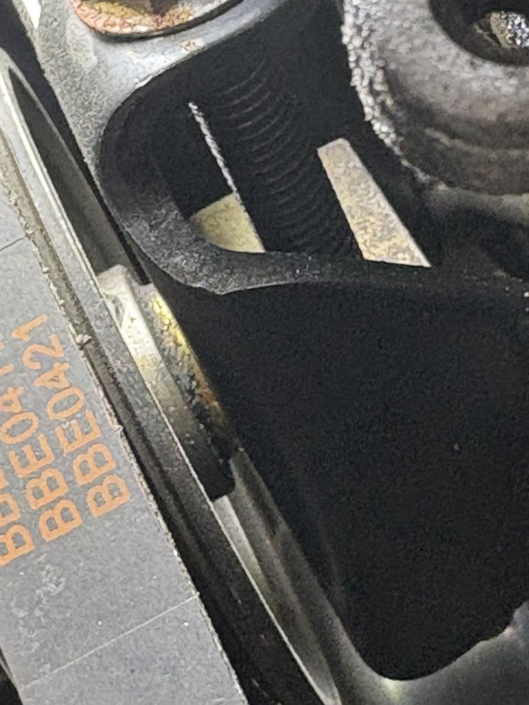

    Thank you s o soooooo much!!! Does this washer go with the fuel line banjo bolt?

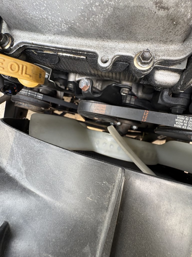

    Hmmmmm
    that’s a pretty fuckin thick washer/spacer
    Beefy
    Most all fuel washers are thin copper
    after looking at mine
    I’m going to guess the belt adjuster spacer for the power steering idler pulley
    Like directly under valve cover
    2nd highest pulley
    The highest is the p/s pump pulley
  19. Jun 10, 2025 at 4:41 PM

    Thank you so so much. I tried it there, it pushed the pulley out too much, and there was already a washer there. Maybe its extra..i dont know.

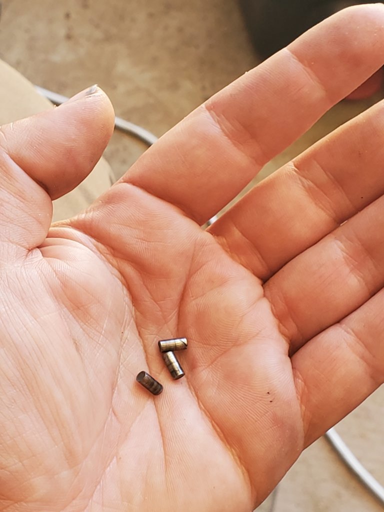

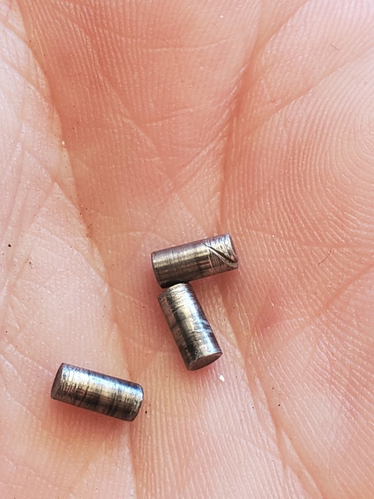

    One more question. I just found these in the debris under my truck. I have never seen them before, nearly everything is put back together, and i have no idea what they are. It looks like the ends spin in something maybe, i dont even know if they are from my truck. There is no where for anything to fall out from anymore, and i have never seen them in the dirt before. It possible i missed them, but ive been down there pretty intensely for days. Help.
