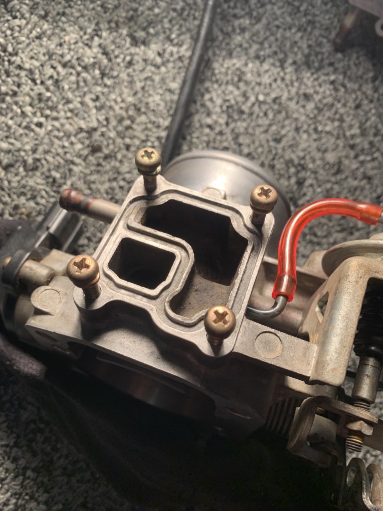

    nope that coolant hose suppose to go to TB!
    that 2nd pix
    short vacuum hose from IAC to that idle control diaphram thing(looks correct)

    The IAC
    That short red hose(your pix#2)

    Yeah that's an excellent pic of the water out on these TB's
    I tried to find a pic of that but.....but could not find right angle
    most pics online show the 5vz's....which is completely different IAC design
