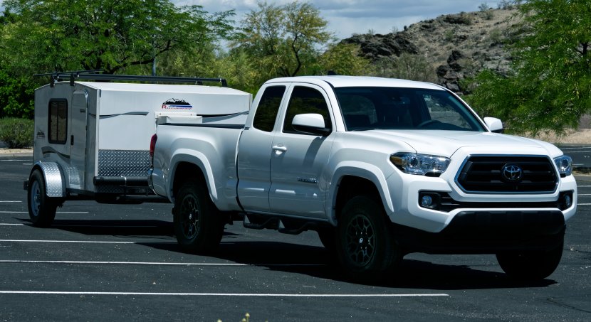

    This little camper is about 1000 pounds. By the time I load the bed with other camping 'stuff' plus the
    jackery and dometic in the back-cab she tends to drop a few inches. This image is with nothing loaded
    in the camper or the bed -
    I don't know enough about the subject - totally ignorant about leaf packs, or just better shocks, or air-bag things.
    How would ya'll handle this if you wanted to.

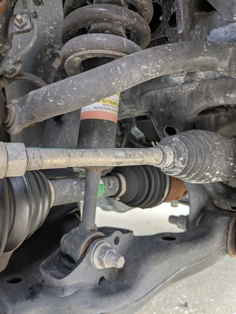

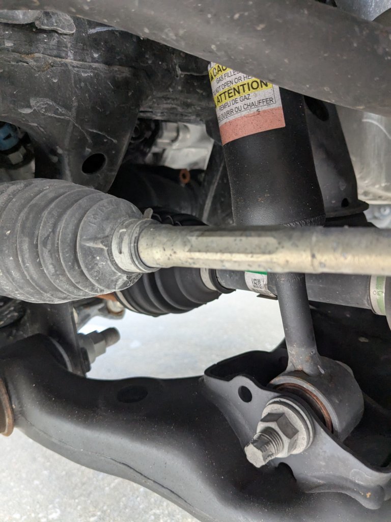

    yotadust
    yotadust [OP] Well-Known Member
    Apr 19, 2025
    #469761
    470
    rears and passenger front are dry but the driver front is moist almost all the way down. You think normal or toast? 2023 with 16k miles...
    Passenger front:
    Driver front:
