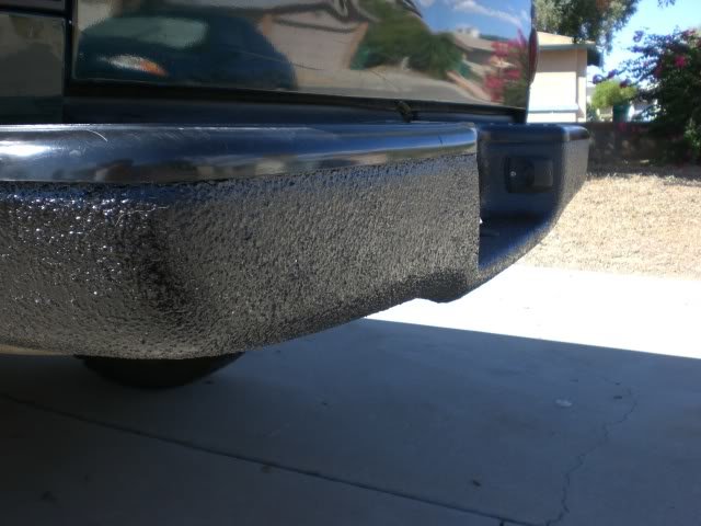

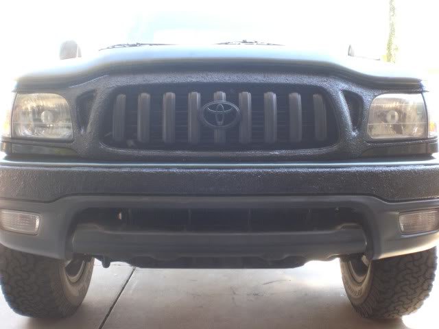

    thanks to will for the write up he did and the tips he gave me prior to me doing this.
    the grille was the easiest part. i just ordered a black grill from ebay that was said it was an oem fit. i lucked out and i actually fit fine. i also took off the corner blinkers and sanded the chrome off with a dremel, wiped everything down that was sanded with some acetone.
    the bumpers were a pain in the ass even with an orbital sander. but with enough time and patience it was ready to be herculined.
    i did about three to four coats of herculiner on everything. i used about a third of a gallon. made a huge mess in the garage but nothing that cant be cleaned up. spent a good part of a day doing it all, just had to wait for the coats to dry.
    i also spray painted the toyota emblem the same green the truck is. i think the whole thing turned out great!

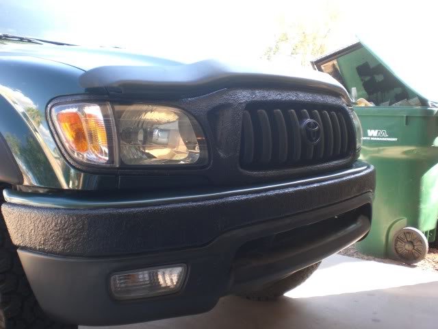

    so i get real lazy when i do things like this. i didnt really tape anything. i dont use tape when i paint things in the house either. just make sure i cut it nicely before actually doing anything.
    but i think it turned out really clean. there was a little bit of run off from the front bumper but i just let it dry. once it as dry i took a scalpel and arefully trimmed the pieces off and you cant even tell. i should have spray painted the radiator black but i completely forgot about it till after i put the grill and corner lights back in and i didnt want to risk breaking the plastics clips.
    maybe next weekend ill just put up some cardboard and use some tape and newspaper and just rattle can it with the grille still on. well see.
    this really got me into my truck again. i was neglecting it for awhile. the lack billet grill i had on prior was really bumming me out.

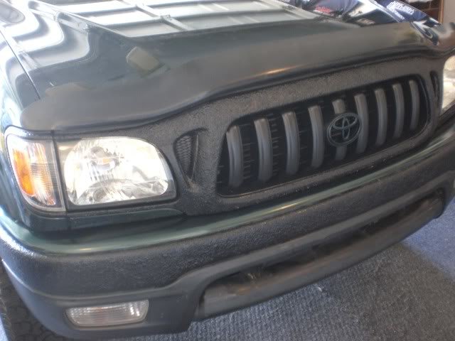

    thats cool man i was looking at the gallon of that at wally world before i picked my herculiner up at checkers. could you post some photos of your grill so i can see the difference?
    i found using the brush leaves a lot of texture, using a regular paint roller leaves the texture finer, and using the blue roller that comes in the kits leaves a thicker texture.

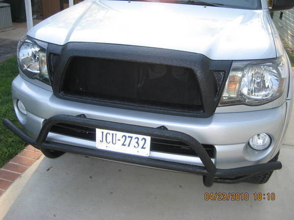

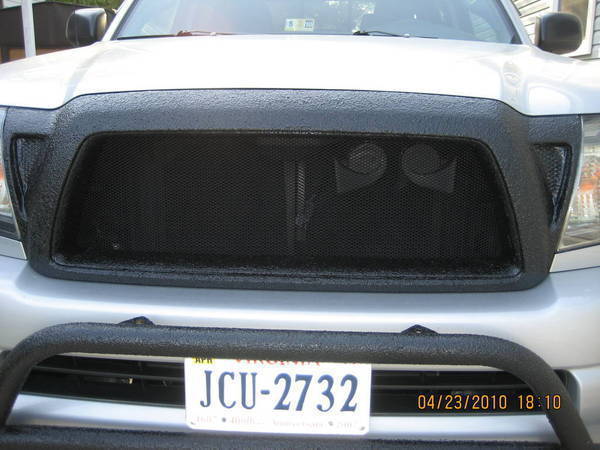

    Thanks Andrew for inspiring me to Herculine my grille. I decided to also put the liner in the little cutouts on the sides and it kind of pooled up and looks crappy. So I might try using some bondo on top to fill up the cutouts and then roll some more Herculiner over the top. Either way I think it looks half decent. That stuff definitely gets everywhere. I had liner on my gloves, shirt, pants, arms, shoes, and even got a little in my hair. Next time I'll go for a hazmat suit maybe then I won't get so much all over the place. The texture is very bumpy, more so than I thought it would be, but it seems to give it character.
    Now I gotta find somewhere to move my horns...
    I also did my Avid light bar and steps.

    ^^^ Hell yeah man! Looks mean. I really think the texture gives it a rugged looks. Be sure to keep some herculiner around, you'll need to touch it up once a year. The black will fade out a little bit, but just spray some armor all on it and it will get its shine right back! Looks good!
