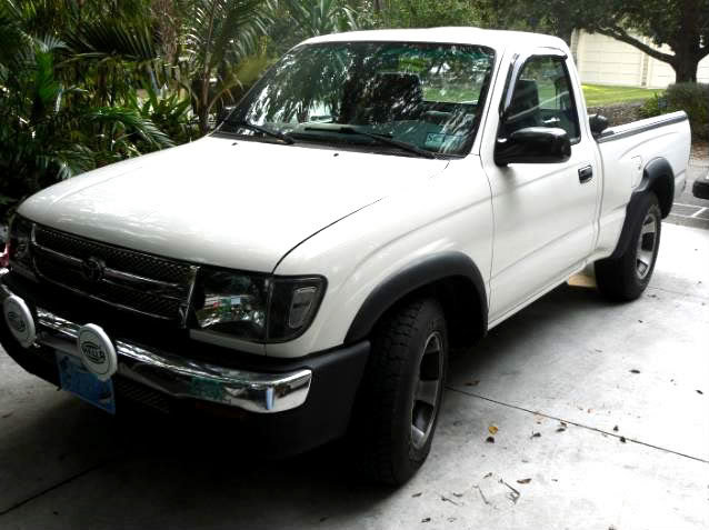

    After seeing some of the pics on here I decided I wanted to do somethin to my fender flares. I wanted something that I could spray on. I bought these two cans do do some testing.
    036.jpg.
    I sprayed a few coats on a subway cup and let them dry. The duplicolor is a little more rubbery, and smoother than the rustoleum. On looks alone I would have gone with the duplicor. Then I started to scrape them. with just a scrape of the fingernail the duplicor flaked off.
    The rustoleum was alot harder to scrape off. Decided to go with it.
    034.jpg.
    I didn't want to take of the flares because I didn't want to have to buy new plastic clips that I knew would be brittle from the sun. I had some cheap sleds made of really thin plastic material, that I slipped in between the flare and the car, thin strong cardboard would work also. I then masked off all around.
    032.jpg.
    I then ruffed them up a little with a sanding pad, wiped them down with acetone, primed them with plastic primer, and hit them with about 5 thin coats of rustoleum truck bed liner.
    035.jpg.
    I kind of like the shiny look, and hit them with a little clearcoat while it was still tacky. Not sure yet if this was a good idea. Here is the front finished.
    039.jpg.
    Did the same thing with the back.
    037.jpg.
    I didn't like the look up inside the flares where is a white undercoating. With the 2" lift it looks funny, so I hit the underside with a black rustoleum undercoating and it looks alot better.
    I only got the flares done on 1 side of the truck for now but I definitely like them.

    Excuse my ignorance but what is the point of painting the already plastic and black fender flares?
  8. Jan 26, 2010 at 5:54 PM
    Will Prerunner
    Will Prerunner [OP] Well-Known Member
    Mar 21, 2009
    #14975
    157
    Tempe Az
    01 TRD Prerunner Doublecab
    Trail-Gear rock sliders, OME Lift, kobalt tool box, herculined fender flares, CrossFab light bar, Deck plate Mod, Differential Breather Extension, 32"goodyear duratracs Pioneer 3 way speakers, alpine head unit, Boss Bass 600 sub, custom az pinstriping
    After they sit out in the sun for a few years they get all scratched up and turn an ugly milky white, you can clean them up but within a few days they are back to looking the same way. Look at my 1 before pick and you can see what I mean.

    Yup, If your going to use a spray I would recommend the rustoleum. Should be like 7 bucks at Wal-Mart. Heres a better pic of it done.
