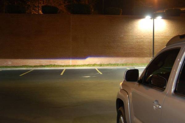

    It's just interesting to me why no one has been able to not get that cut off perfect in the middle? Is there a reason?

    Not sure, I think I was lucky to have it that close think I am at the max adjustments.

    Do you mean the step looking like one step and not divided into two or the step actually being centered in front of the truck?

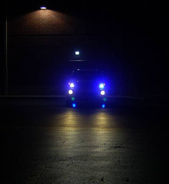

    Just went back out for more pics. Don't think it gets much better than this one. While driving it is in the center of my lane centered on my Tacoma. It looks off centered because I am shooting the pic from the left side of the truck.

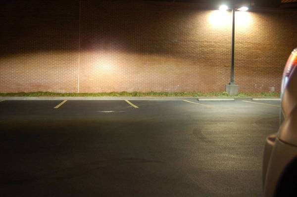

    High Beams (Bi Xenon).

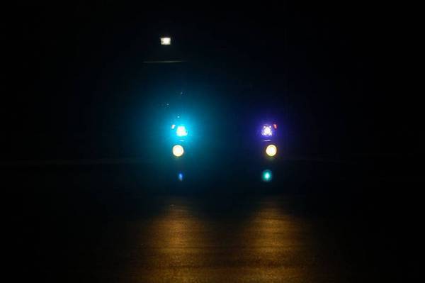

    Flicker #2 as viewed from the Step.

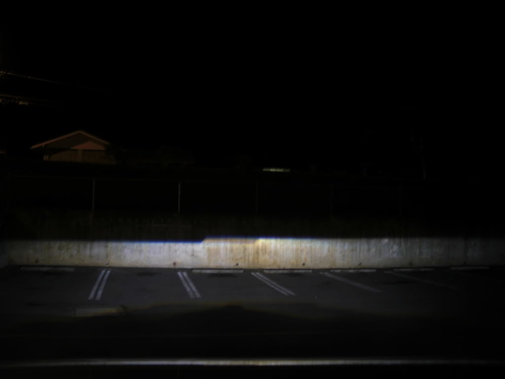

    It really is better to have 2 visual steps no matter what the distance is. Factory hids are aimed with 2 steps. You get more width that way. The general distance is 2-3 feet apart at 30ft or so. Here's what mine looks like.
