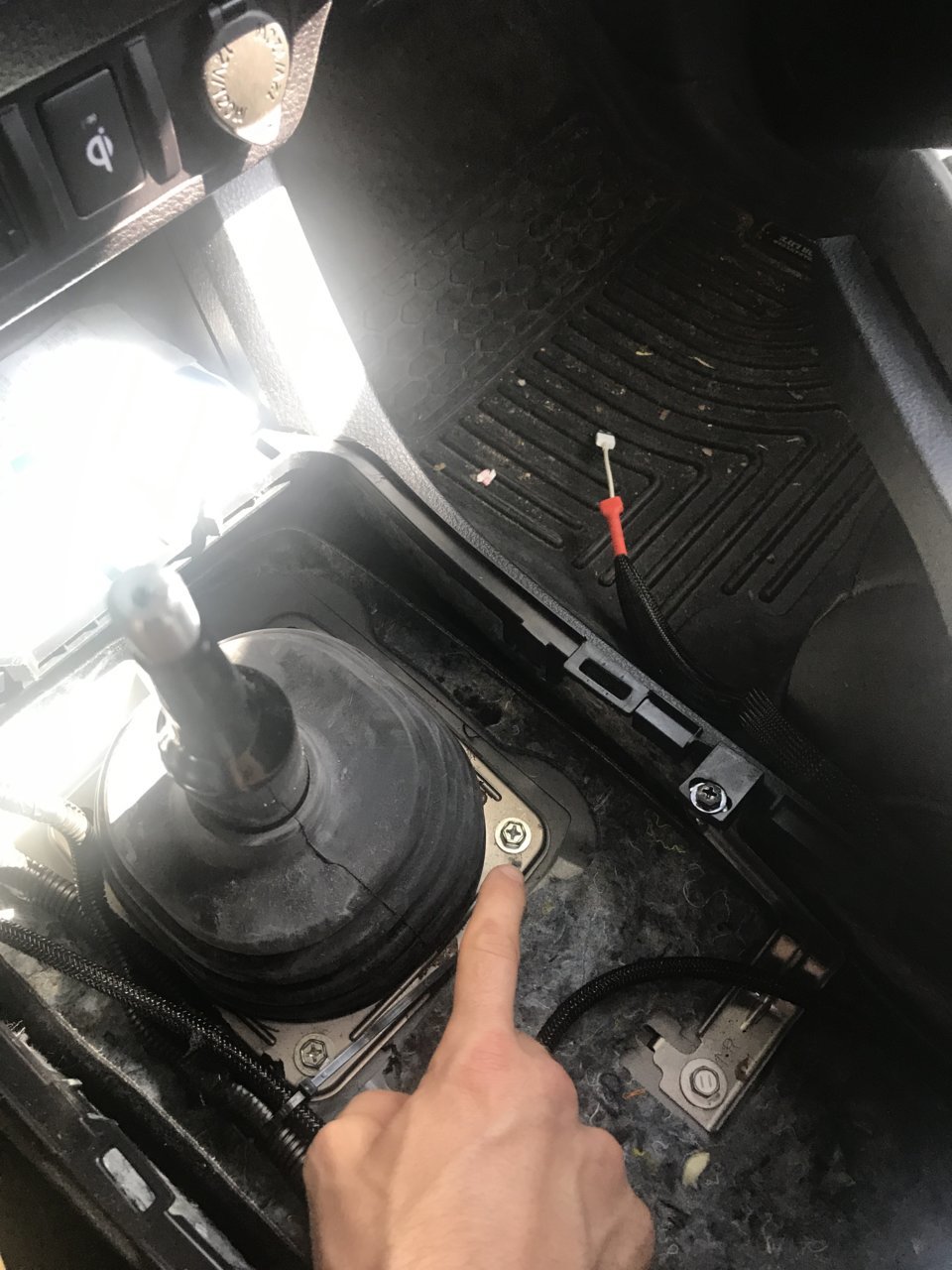

    So I'm at the boot. Do I need to unscrew the bolts at all or just fanangle it out?

    There are no bolts to get the console out.

    First issue with the truck ever. If it is the bushing, I just about have the shifter off at this moment and it's hardly a problem.

    Nah nah nah. These bolts with this boot. I'm ahead of ya hah

    Yeah, take those out and lift that up. But you probably already did that. Waiting for next pic.

    Is there a trick to the clips?
