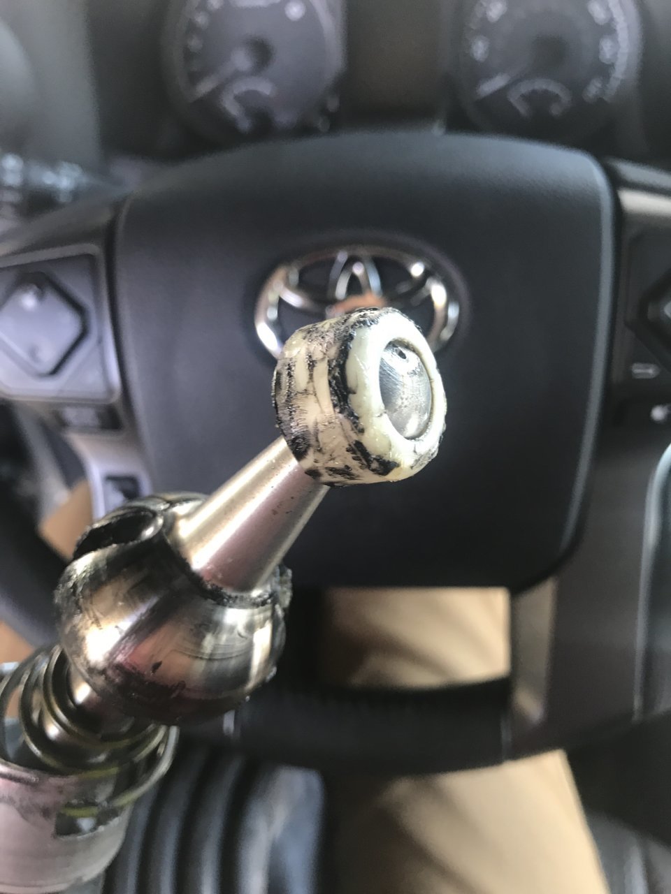

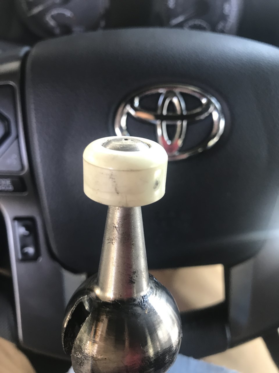

    Ok. What do y'all think?

    Does it actual look dead though, Jim?

    Looks fine to me. Nothing bent or broken.

    There is a little bit of play on the ball though.

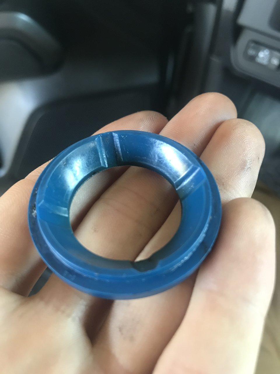

    Now show is that blue do-hickey up close.
    The seat, I think.. yeah that's it. Show us that thing.

  12. Mar 21, 2019 at 2:35 PM
    #52
    CanadaToy
    CanadaToy Well-Known Member
    Nov 7, 2013
    #116081
    1,716
    Greg
    Toronto
    17 DCSB TRD OR Alpine
    TRD Pro grille & skid, OEM tonneau and roof racks
    It's mint.

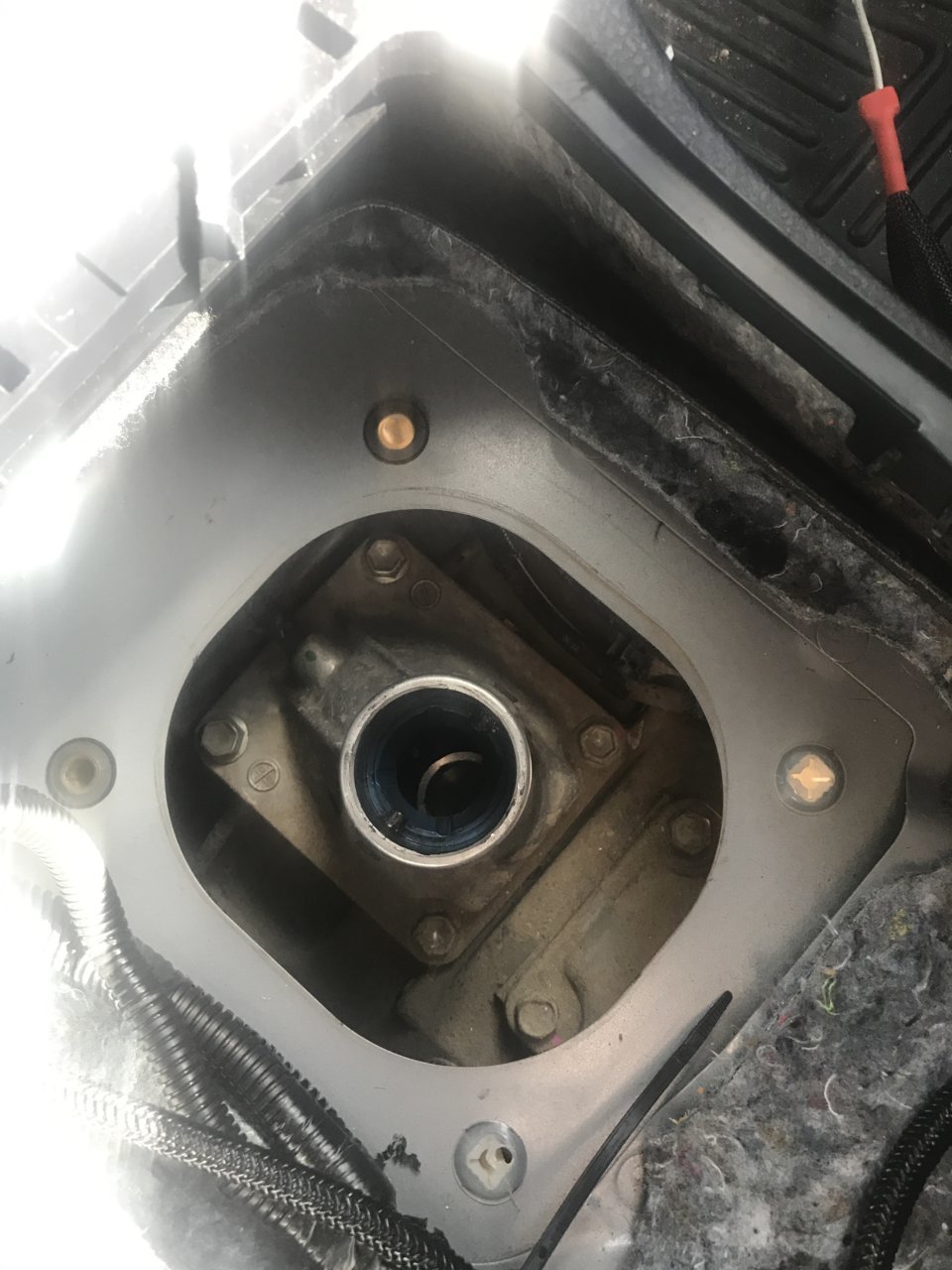

    Take a pic down the hole. take a pic from underneath.

    As for underneath, let me get the tranny skid off real quick

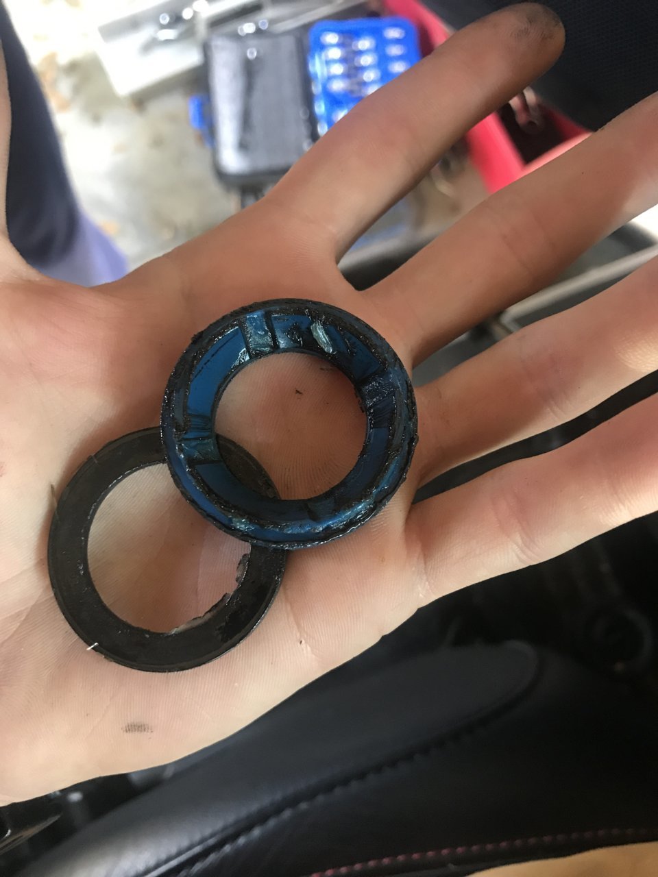

    Fork broke ? When those bushing’s wear down you get a sloppy shifter/loose feeling. Not what you have. Something broke further down the line.
    Don’t forget to grease those bushing up before you put it back together
