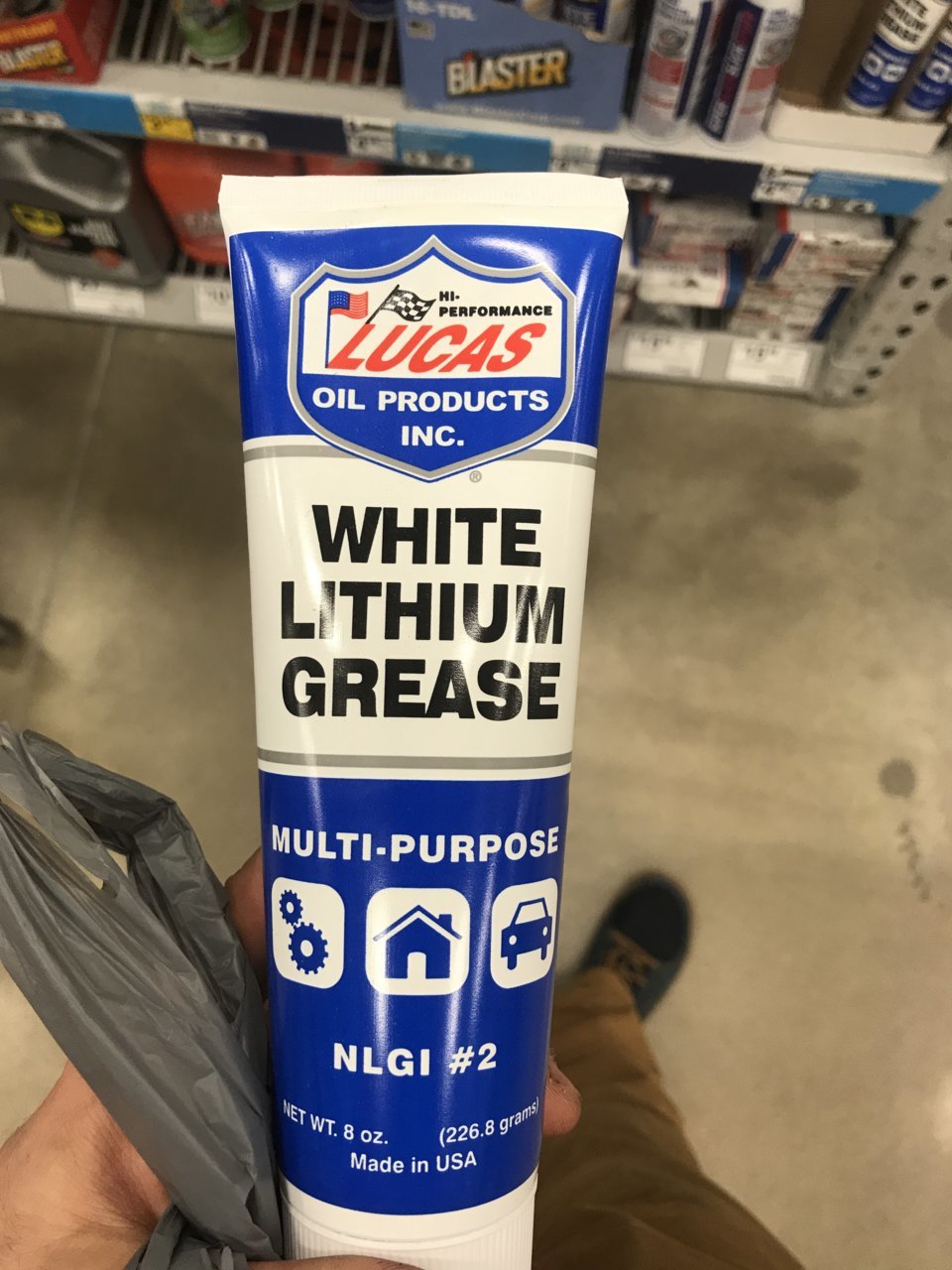

    What lube should I use for those bushings @tonered ?
    Would this work?
    tonered likes this.

    12,654
    Nick
    YMH
    Black '17 OR
    Anything. Lithium should work.
    tonered and Alesimo[QUOTED][OP] like this.

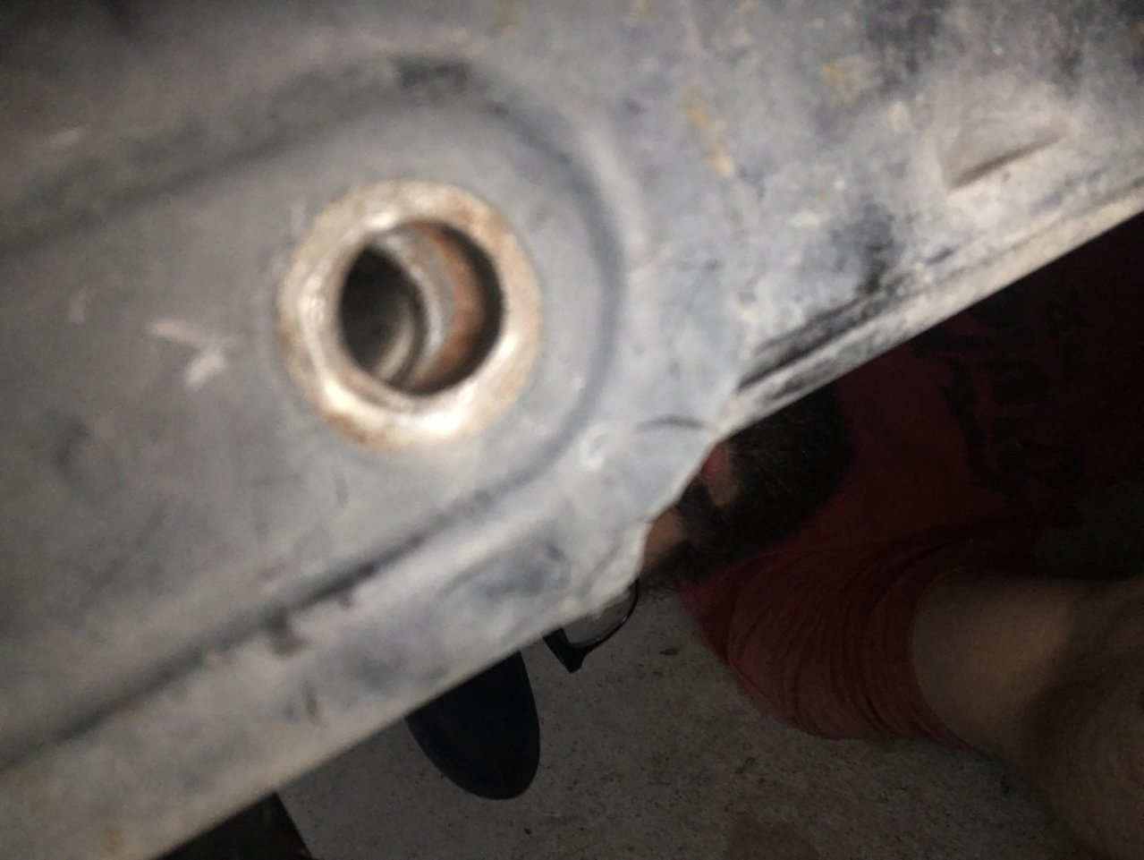

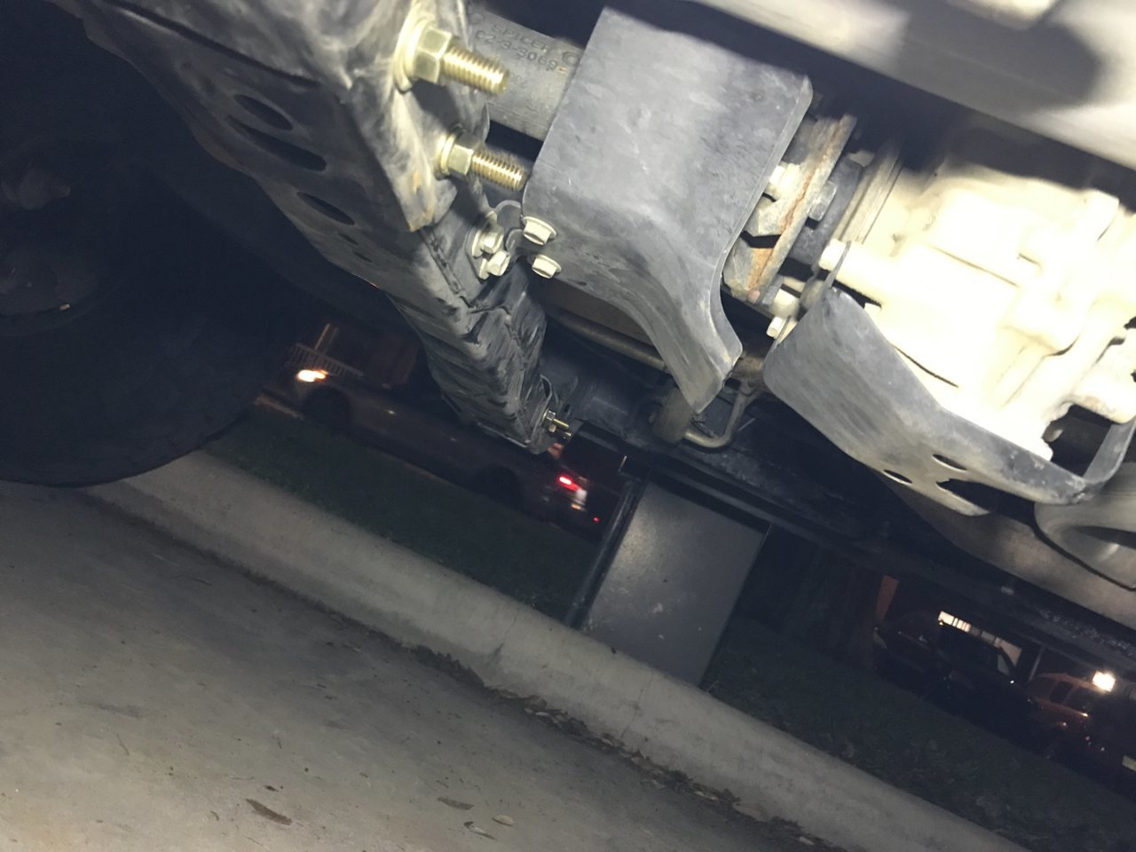

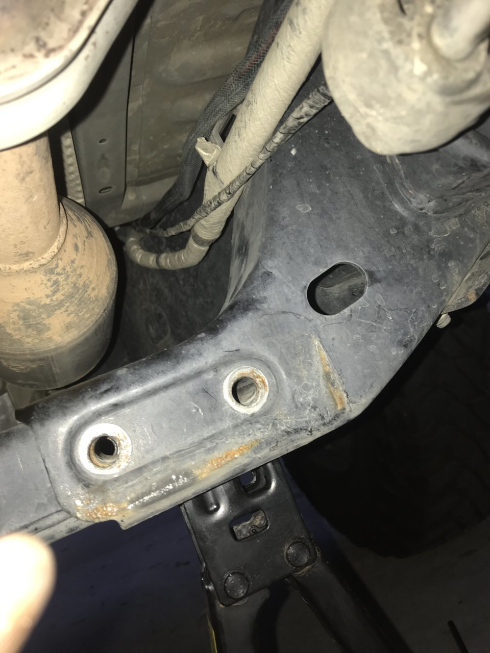

  5. Mar 21, 2019 at 5:37 PM
    #145
    Alesimo
    Alesimo [OP] Jeeper
    Sep 29, 2014
    #139352
    1,084
    Alec
    Houston, Texas
    2020 Jeep Wrangler JLUD

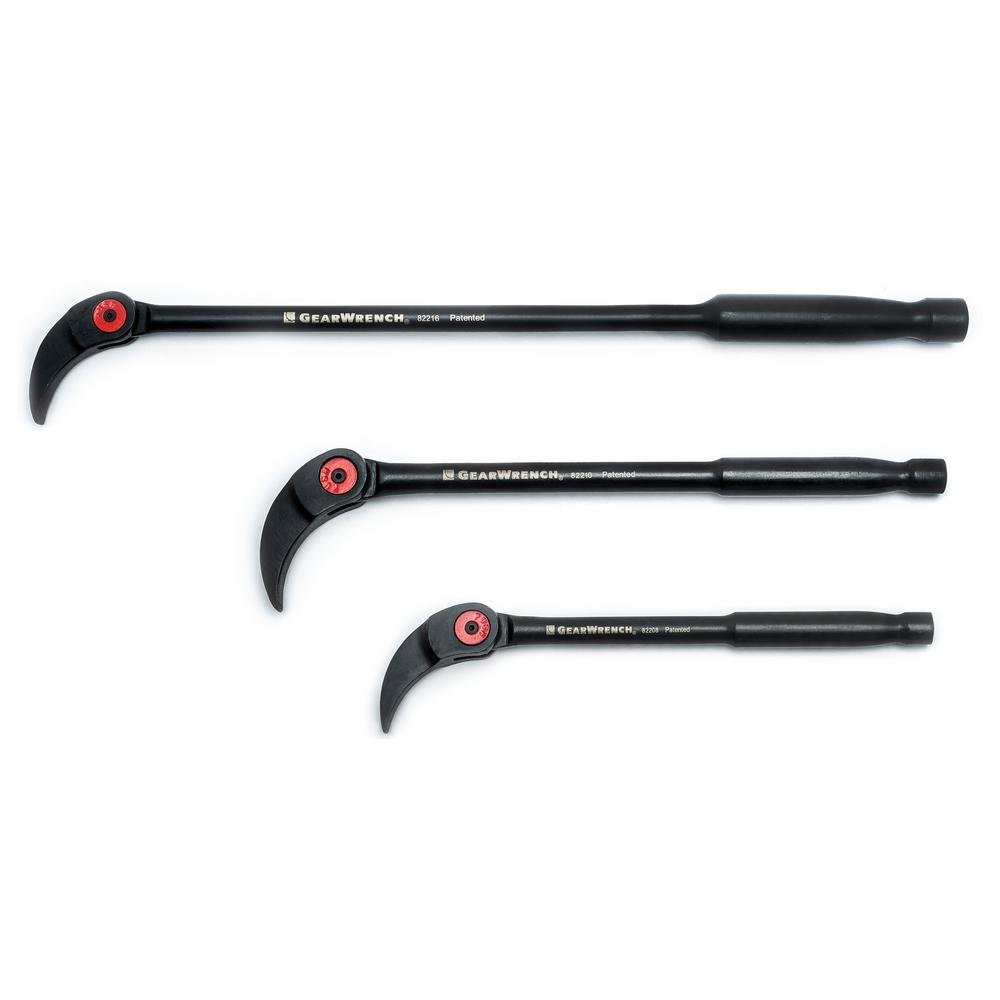

    Guys this thing may not work without the crows feet!
    I have one pair in on the driver's side and I can't get the passenger holes to line up.
    From back to front they line up, but the other way, they are way off.

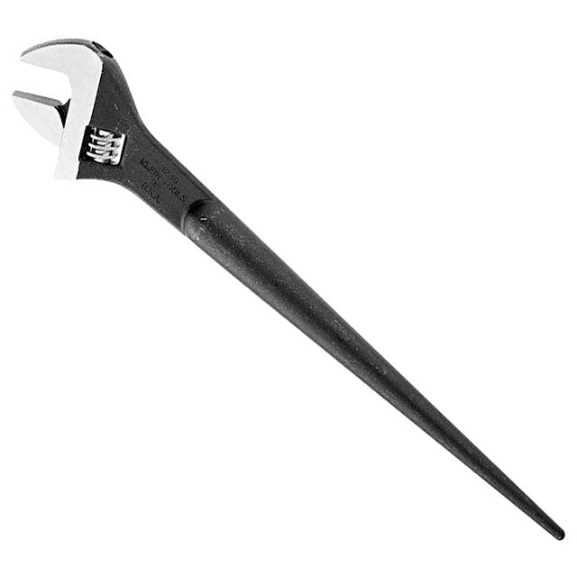

    Got anything you could use as a makeshift drift pin? I'm sure you've already left the store but sometimes home Depot/Lowe's will have spud wrenches which are similar to the crows foot, basically a crescent wrench where the handle tapers to a point.3239-2.jpg

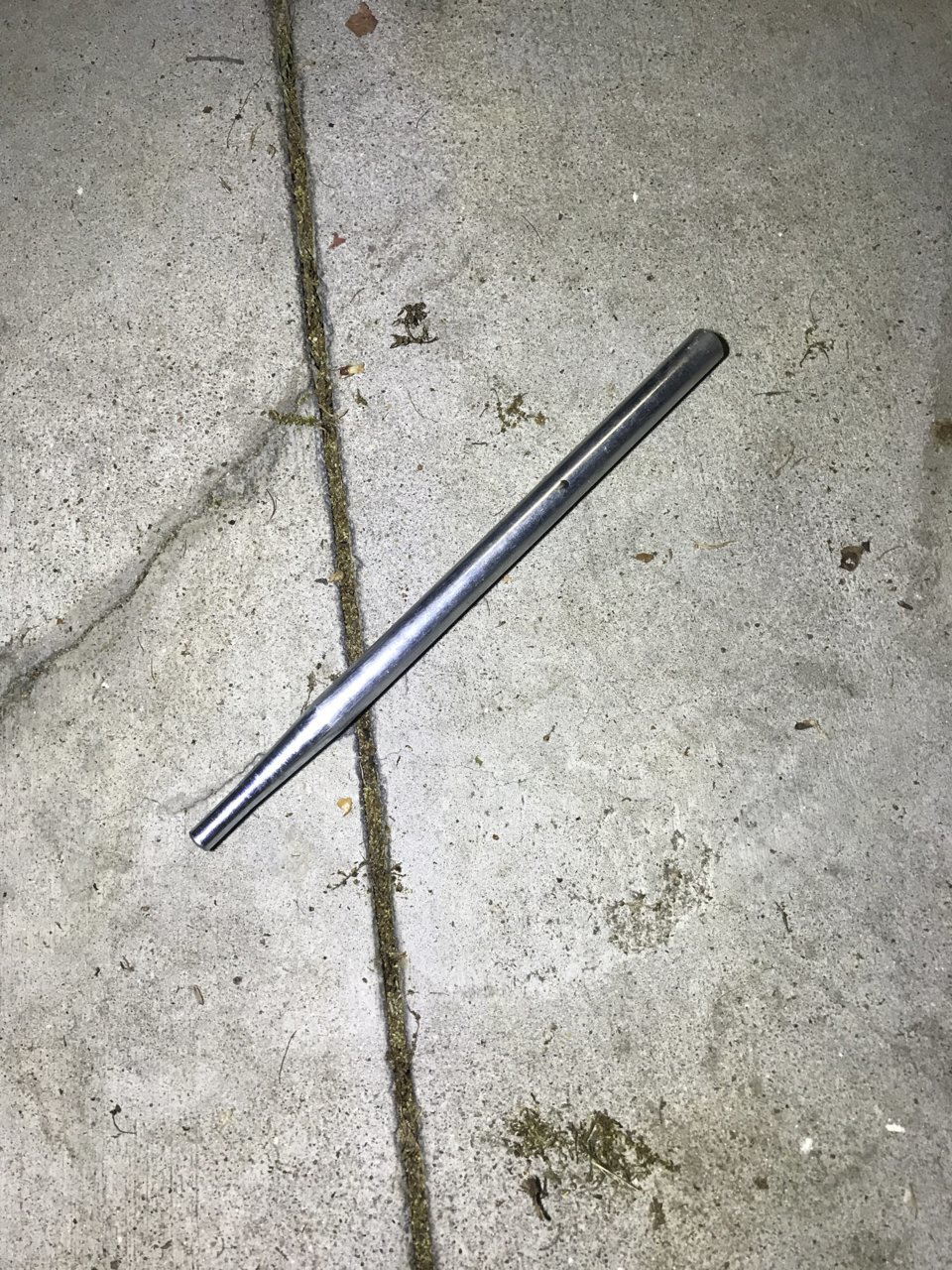

    I knew this worthless preload adjuster would come in handy!!!
    Worked like a charm. Underneath is buttoned up. Now time to reluve the bushing.

  12. Mar 21, 2019 at 6:12 PM
    #152
    Alesimo
    Alesimo [OP] Jeeper
    Sep 29, 2014
    #139352
    1,084
    Alec
    Houston, Texas
    Looks way more lined up down the ol hole!

    Good recommendation right here. Everyone who spends time wrenching should own a drift pin. It’s one of the most useful tools in my garage...second only to the dead blow hammer.

    If you end up getting some eventually, take a look at the ones where you can adjust the angle. Very useful.

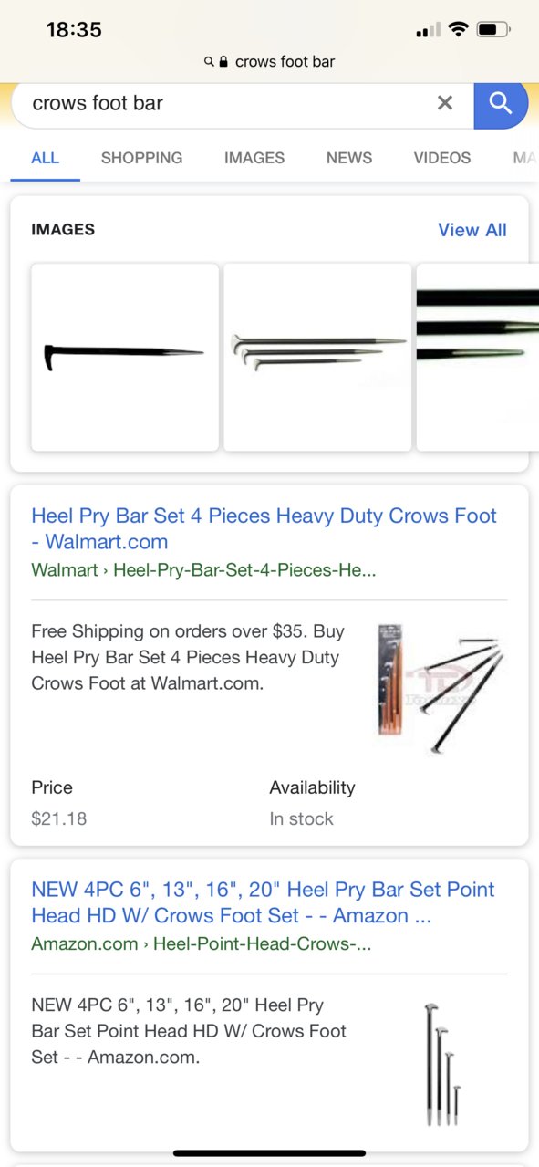

  17. Mar 21, 2019 at 6:33 PM
    #157
    neegra
    neegra Well-Known Member
    Sep 26, 2015
    #165210
    146
    GA
    2016 DCSBTRDOR4x4
    +1
    I've always known a crow's foot to be a type of wrench, not a pry bar. Basically an open ended wrench attachment for a ratchet or breaker bar
    Glad you resolved the issue OP!
