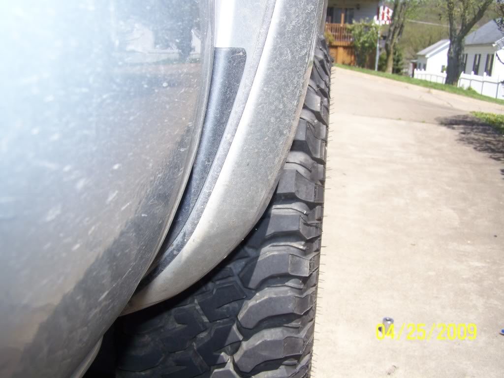

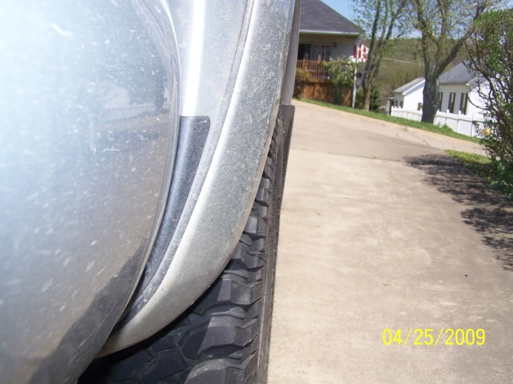

    I just installed my wheel spacers and figured I would do it as a MOD. I decided to do these since I went from a 265/65/17 to a 255/75/17 and lost some width. These are 1.25" Spidertrax, now, I don't like the blue anondized so I painted them black with wheel paint (my personal choice).

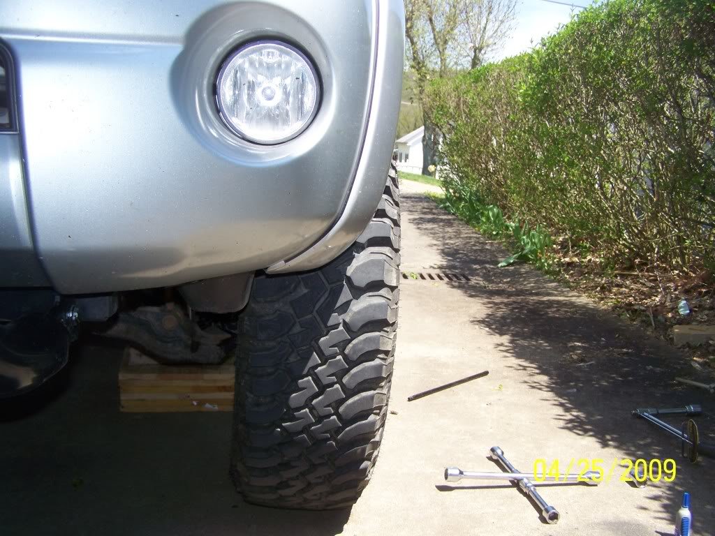

    Step 1-Pull your wheels (I did mine 1 at a time.)
    Before the wheel spacers.

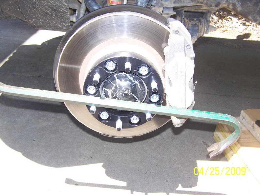

    Step 2-Install the wheel spacers using the star pattern to tighten lug nuts. Now, I also used Loc-Tite to ensure they stay. Tighten them to factory specs (85 pounds).
    If you are doing this alone as I did. You may find it handy to have a "brace" to help with tightening the front nuts. The back ones are no trouble if the emergency brake is set.

    After Wheel spacers have been installed.
    As you can see, my toe in needs adjusted! Going to be done tomorrow.
