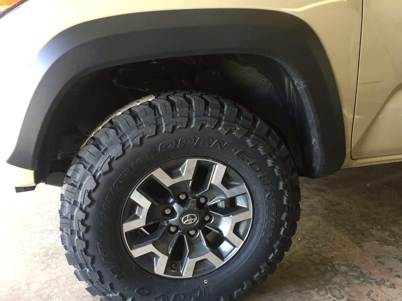

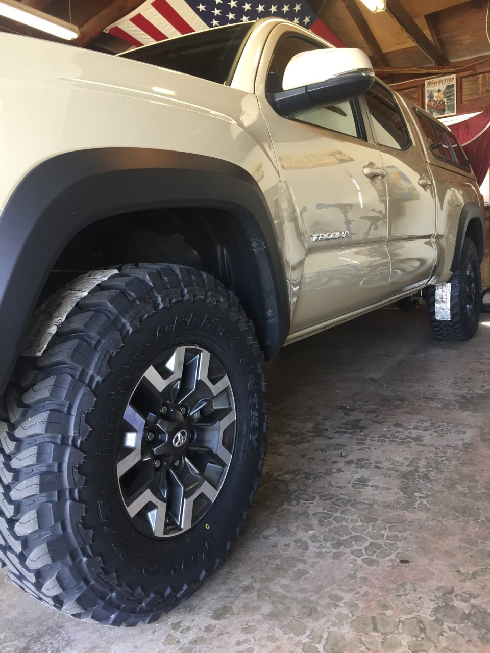

    Well pulled the trigger and ordered the first piece. 265/75r16 toyo opencountry mt. Should be in Monday. 920 out the door mounted balanced. From what I've seen on here no rubbing should happen with this size I'm hoping I'll have the same luck. I'll be sure to post pics when done. Decided on the 265/75 based on people saying under powered with the 285s.

    Here are the tires as promised.

    Assuming lift is involved here, I'd hold off until you know you need a lift to do what you want to do.

    No lift here. Just 265/75r16. No rubbing. I think I'm pretty happy for now without a lift. Probably sliders next.

    @Pbguy09 nice rig. I too have no lift currently but would like to get into 265/75r16 tires for a little more functionality for off road. Can you tell if just by adding those, you added any overall lift to the truck itself just with tires? Nice pics, btw, thanks for sharing.

    @azstruble so the stock tires I had were 265/70 actual measurement I believe was 30.5. The actual measurement for the toyo open country was about 31.5. I and I believe the cooper discovers I was Looking at were 31.8. So I got about a .5 inch of lift overall running at 35spi and the weight of the truck after being mounted. It's not much of a lift but it's something. It was more for performance than the lift. mainly added sidewalk strength. Hope this helps. Any other questions feel free to ask. always check the manufactured tire charts for true measure the the tire. Not all 265/75s are made equal. I'm just about maxed for width without spacers or a new rim from rubbing on the uca.
