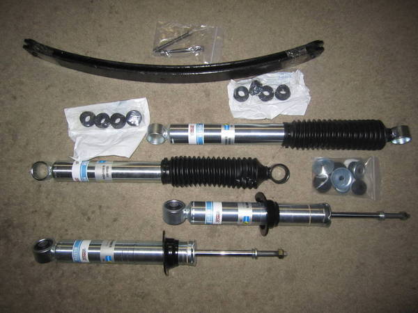

here it is boys, my lift

    i put this in the 1st gen cause all the info in the suspension forum pertains to 2nd gens. so i had to space out my purchases due to funds but everything is finally here. i know this has been done many times before but this one is mine. i called a couple of local shops and due to pride and stubborness i will not be paying anyone to do my install. however, i do have a few question... hope to install Thursday or Friday
    1. are there any extra parts i might need to complete this install (tool excluded)?
    2.if the aal's claim a 2" lift and my truck sits level pre-lift (i'd like it to stay that way) would i set the 5100's all the way up or use the middle setting?
    if anyone could post any links that might help. thanks to all in advance

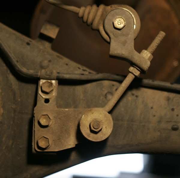

    Extending the brake line may not be necessary if you are going less than 2" but raising the BPV arm by the amount you lift is important to maintain the braking balance front to rear.
    Here is the before:
    and after. This is for ~2.5" of lift.

    Whats the BPV arm? No one ever mentioned that when doing a AAL and like you said it may not be necessary,I never moved the BPV arm what should I be looking for that would indicate that I need to re-position it, I just finished a 3 leaf mini pack on mine, I was only looking for 1.5 and thats what I got.

    the search function can be your friend. :D
    http://www.tacomaworld.com/forum/1st-gen-tacomas/59828-brake-porportioning.html

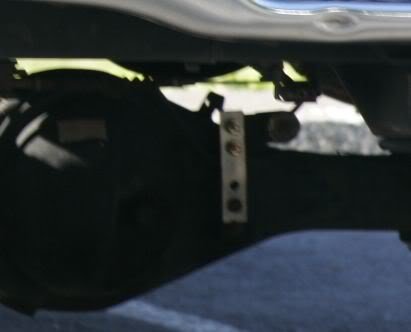

    I recently put the same lift on my truck, but put the 1.5" AAL on the back. My truck wasn't sitting as level as your is now. If you have your original coils on the front I would recommend setting your billies up front to 2.5". I only got about 2" of lift up front with the billies at 2.5" and my original coils due to sag overtime (I have an '02 extra cab 4x4). My truck still seems to sit a shade high in the back, but pretty darn level. See before and after pics below.
    Also, I did not put new u-bolts on. My original ones were just fine. There is plenty of room with the old u-bolts for a new leaf, but you do risk messing up the threads on a rusty bolt or thread damage already existing. Wouldn't hurt to get under there and check them out and when you do remove them squirt a little liquid wrench or rust remover on there before you apply torque.
    Before:
    After:
