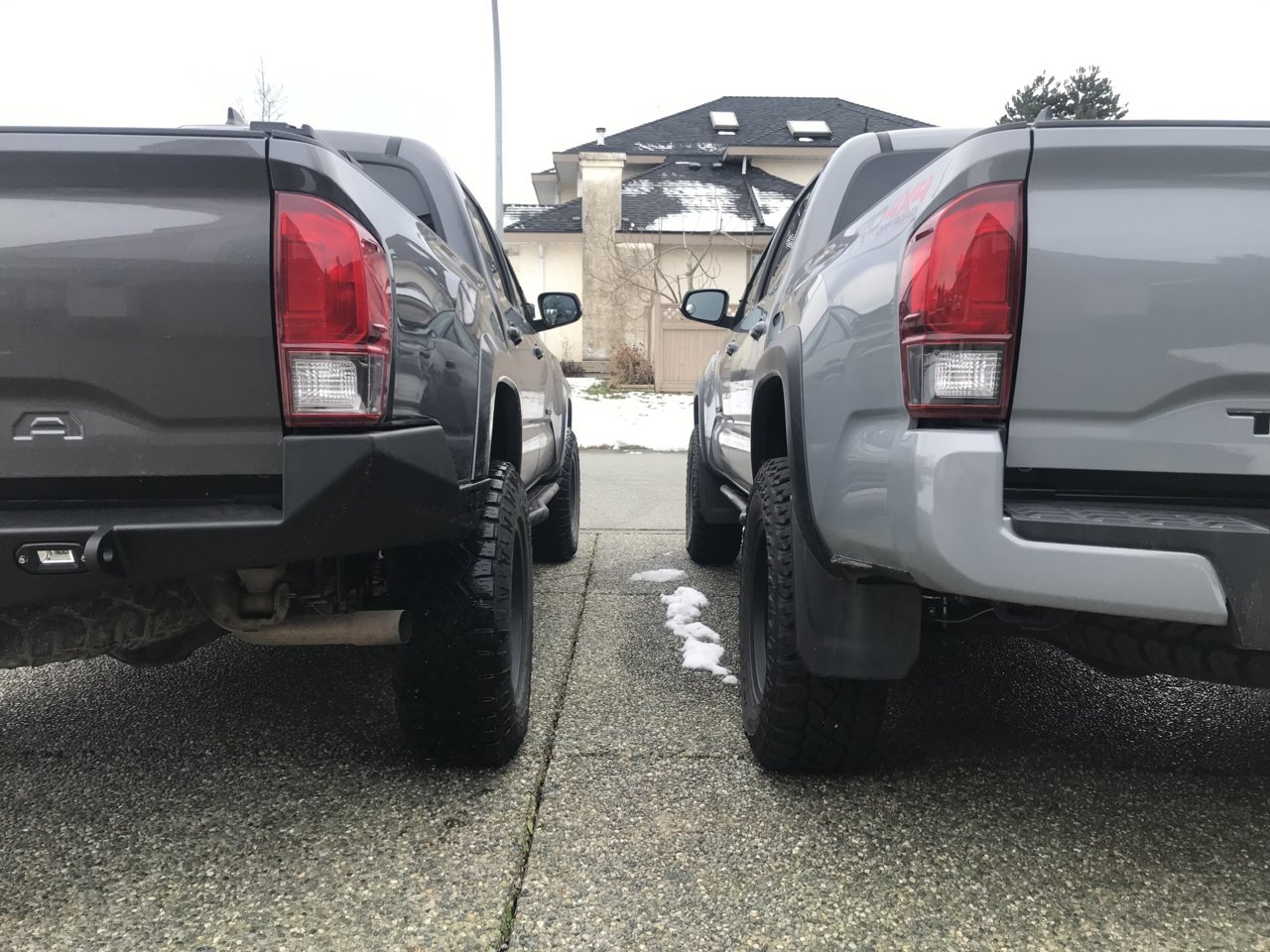

    275/70/17 will work for you, no cab mount chop. I put this lift in for co-worker. He has never had an issue. He barely rubs in mud flaps in front which he has had zero concerns about and ignores because it is so infrequent.
    Left truck is 265/70/17
    Right truck is 275/70/17

    Nope. He literally barely - barely touches the mud flaps. Not worth his time to fix it. Lol
    Play with the tire size comparison. Size difference between a 285/70/17 to a 275/70/17 is not noticeable when parked side by side unless you suffer from OCD.
