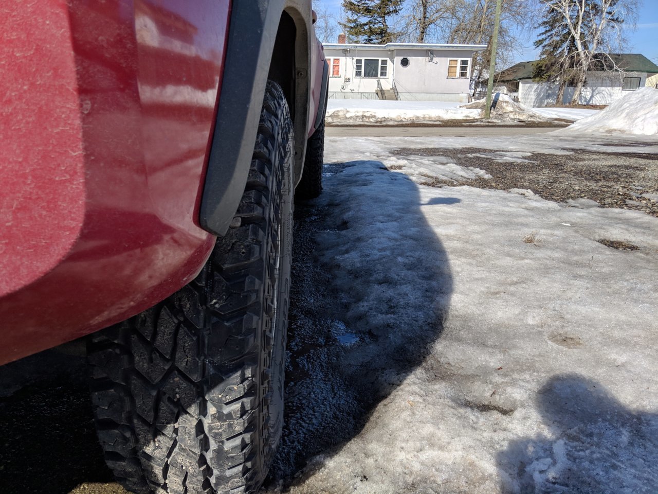

    The 255/80R17 will look fine with a 0 offset wheel. I wouldn't worry about them looking too narrow. I have 255/85R16s and they look fantastic, not too narrow. The only thing I would change is buying some 0 or mildly negative offset wheels to bring them out farther in the wheel well. I would cancel the spacer lift order and buy a cheap set of coil overs and an AAL

    If you're willing to put a block lift on your truck, spacers aren't gonna hurt - the blocks will be worse for your vehicle. Just make sure you torque 'em in the correct sequence and use extended lugs if you need to grab more threads. I have stock off road wheels and while I like the wheels they're an offset of +24mm. 0 offset SCS F5s will bring it flush with the fender which is perfect for me and they're light to boot!
    And don't worry about the people bitching about doing what you want to your own truck, it's yours so enjoy it. However I suggest using google (Tacomaworld ____) next time, the TW search bar isn't as useful if you don't happen to word your search in the exact way someone else worded their title. Yes 285s will require cutting and a CMC unless you don't care about your tires rubbing. 275s will likely rub in full-stuff or wheel lock scenarios but on the daily you might not need to worry about it. That being said! the backspacing on those wheels is pretty deep. Most after market wheels I've seen near 0 offset are 4.5" or less backspacing and that .25" whether it seems like a lot or not is going to make a decent difference between your tire and your UCA and/or cab mount. 265/70s will not rub even with stock wheels and they look decent. You can find tons of these photos in various wheel/tire set up threads. Here's one with 20 pages of questions, input, photos regarding 265/70s and a small lift - https://www.tacomaworld.com/threads/265-70-17-with-1-5-to-2in-lift-pics-please.449869/
    Here's a link to a guy installing wheel spacers on his truck albeit much wider spacers, he goes over Extended Thread lugs at 2:50 - https://www.youtube.com/watch?v=38E96jIbuzw
    Here's a link to the big 255/80R17 thread with 20 pages - https://www.tacomaworld.com/threads/255-80-r17s-pizza-cutter-thread.525039/
    Here's photos of my truck with stock wheels (+24offset, 5" backspacing) and 255/85R16s. They look narrow from head on with stock wheels but any other angle they look fine. They don't rub on the UCAs or cab mount.
