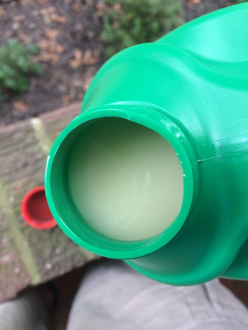

    Yeah, it was for my wife's Escape which was parked behind my Tacoma in the driveway. :facepalm:Luckily a friend was already on the way here and took us to WalMart.

    First time I'd ever bought it, honestly. I've always used Castrol, but the QS was $6 cheaper so I figured I'd give it a shot. Definitely will not buy again.

    Let us know what Quaker State says. I doubt it was their fault, more likely a WM customer who scammed the store.

    That looks like moisture/water to me. Makes the oil look milky. Maybe it was exposed to many hot/cold cycles before it was sold. Hot Truck or Hot Warehouse to a Cold store? Just speculating since the jug was sealed.

    Thats an old tweaker trick to get the oil for free. They know that Beatrice working the return desk wont open the jug to confirm whats in it. And if she does, wont know the difference. I used to run with some shady people long ago and saw it happen all the time. Never personally did it myself.

    So what's in it? Lard/bacon grease, fryer oil, coconut oil?

    Looks like some sort of pariffin, like a waste material not meant to to be sold/distributed.

    Looks like water mixed with the little bit of residual oil that was left in the jug.

    Will do. Just figured if it was a scammy return, the jug would have been dirty or had an oily film on it. Wasn't the case at all.
    Apparently Quaker's parent company Shell shuts down all customer service lines on the weekends, so it'll be Monday before I hear back from them.

    Don’t send it back to them. If you do, you’ll probably never get an answer for what it is or what happened. You should take a sample and have it analyzed. I think the tests is cheap. I bet there is enough interest in this thread to drum up a few bucks in donations to cover the cost.

    How would I go about doing that?

    @jowybyo may have been talking about a place like Blackstone, but I'm not sure they'd be able to identify it. In order to run lab tests, you need to at least have an idea of what to test for, otherwise you're shooting in the dark. If it's some type of petroleum, you could contact an environmental lab and have them do a full test for TPH (total petroleum hydrocarbons), including oil range organics (ORO), diesel range organics (DRO), and gasoline range organics (GRO). A semi-volatiles test could also help ID the material if it has any hydrocarbons in it. Of course, the results would need to roughly match a known material in order to get a positive ID, which the lab might be able to do.
    Going the testing route could be expensive and may not be worth it. If the seal was not broken when you opened the bottle, then it's probably safe to assume that the material is probably an oil production byproduct.
