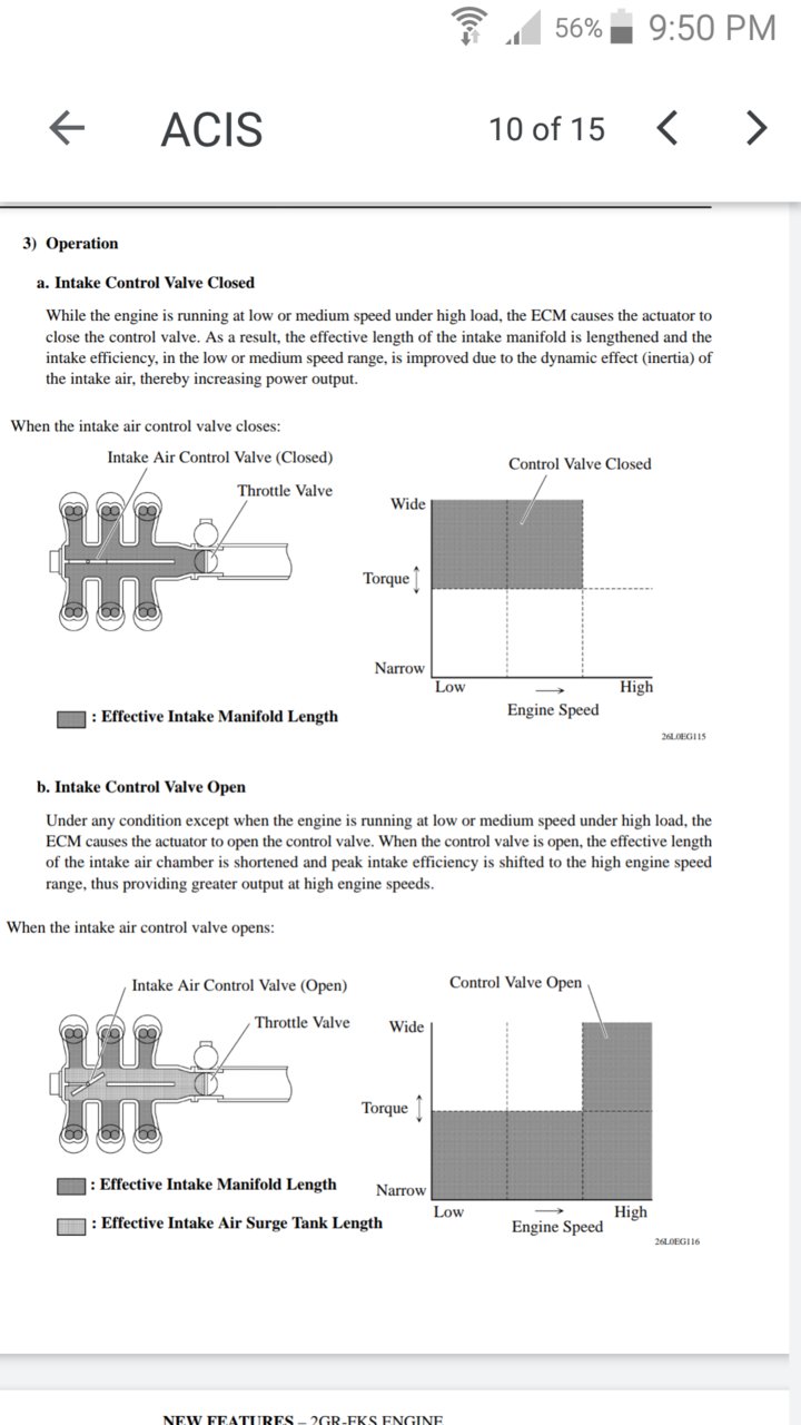

    Is this an accurate representation of the what/when you're trying to describe?

    Possibly. Could the valve opening or closing cause a momentary loss in power? And I mean momentary, like sub-1/4second. Or could the valve be popping open or closed for a moment due to poor programing or other glitch? I've noticed that it can happen multiple times in close succession if I stick with one gear from 1000 up through 3500 RPM, well north of my typical shift-point. Like, hypothetically, at 1200, again at 1600, maybe again at 2200 or something, but I haven't been able to nail down specific points in the range where it always happens.
    I'm hoping I can get a bit more detail about the circumstances of its occurrence, if there is any rhyme or reason at all.

    AFAIK, there's not a whole lot of specific info on exactly what conditions the system operates, other than what I posted.
    The service manual has two tests you can perform to see if the motor operates. I don't know the corelation between flap door open/closed flap and motor clockwise/counterclockwise...and, just because the motor operates, doesn't necessarily mean the flap is.
    Note, that one of the tests reverses polarity at the terminals to reverse direction...
