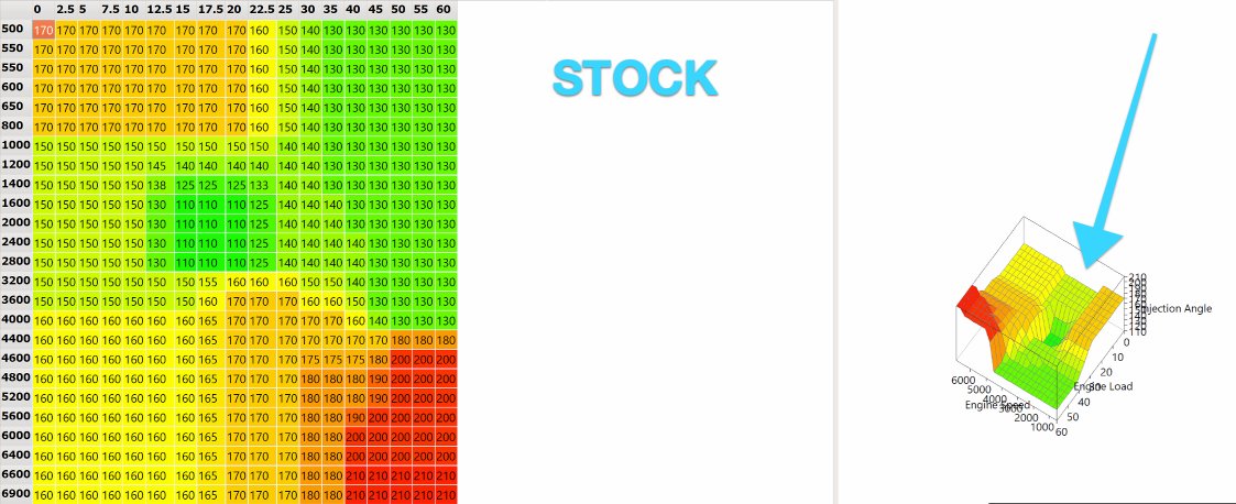

    It is not about having low torque. The issue is the engine feels like it is misfiring, jerks around and you get split seconds of no power and then power is back. It feels exactly as a carburated engine with the jets for mid power clogged.
    I don't mind the low torque as long as the engine is smooth, like every single other manual car I have driven in my life

    Is not. I know what I am talking about, and I have driven many manual cars, carbureted, port injected, direct injected, 4 cyl, 6inline, v6 and v8, from 1990 models to 2022.
    What the Tacoma is exhibiting is not normal. At least compared to any other car out there
    For comparison my family in Venezuela have 2 chinese cars, both manual transmission. Those cars have zero torque in low rpm, however the engine in both of those cars is smooth as butter all through the rpm range and never misses a beat. There are many examples like that.
    I am sure what I am experiencing with the Tacoma is not normal, and others are feeling it too. Maybe you don't understand it because you are not experiencing it, but I am 100% sure is not normal.
    Also every now and then the Tacoma just transforms on what it should have been from the factory. Low torque but a very smooth engine. Then it gets possesed again and goes into this weird mode for many miles until it comes back from the upside-down.

    The problem that some of us are experiencing, is that even in that rev-range with mid-throttle the truck still does like it feels as a misfire. I know it sounds like it doesn't make sense, but some of us are experiencing this, and the ones that are experiencing it describe it the same.
    The computer does not detect any misfire but it is definitely noticeable, specially when the truck all of the sudden starts to behave completely normal and it feels amazing for a while.

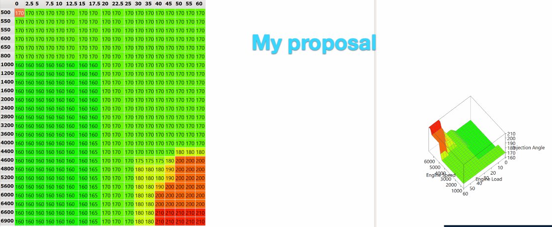

    Do you have an ODB scanner that can force port-injection only? When I do that on my truck it runs amazingly smooth. If I force to direct injection only, it runs like crap again (randomly).
    If you can repeat the experiment at least we'll get some consistency that the problem is related to DI
