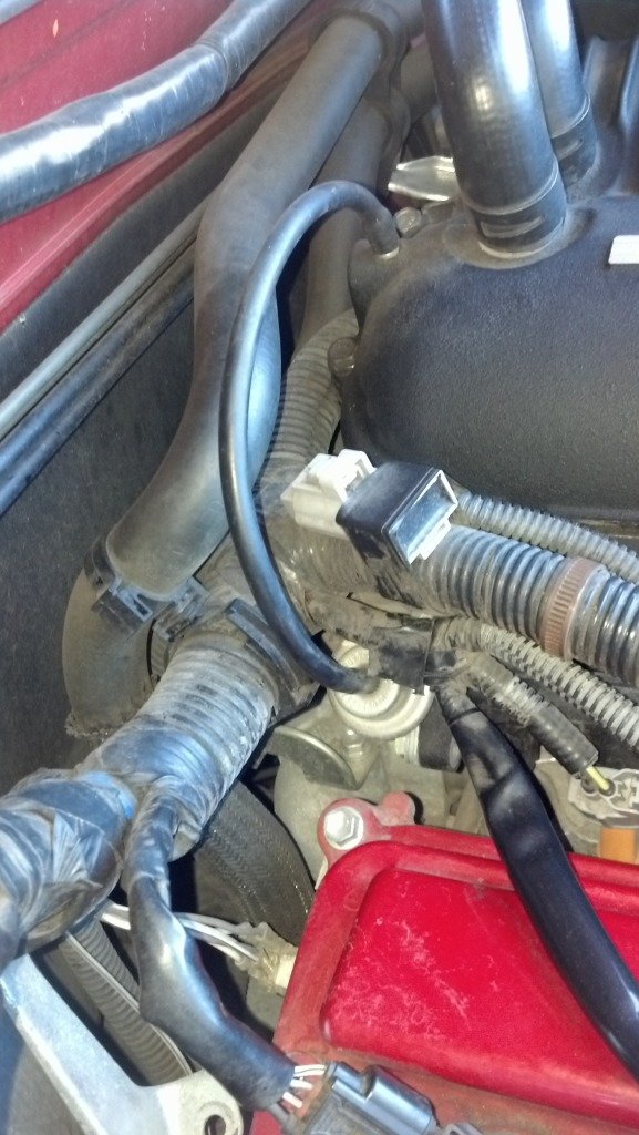

    Just to clarify, that is in fact a fuel diaphragm, I believe Toyota calls is a fuel rail dampener. It reduces the vibration from the fuel pulsing from the injectors IIRC. The fuel pressure regulator that you mentioned is actually in the fuel tank on the fuel sending unit. I had to replace on years ago for a vibration/noise.

    The piece at the end of the passenger side of the fuel rail, is the fuel pressure regulator.
    The damper is on the driver side.
    On N/A, and S/C, following the factory directions, a vacuum hose routes off a nipple on the intake, to the nipple on the FPR.
    Which is not like it is in the picture which I posted. This routing is if you want to do the FPR mod.
    Listed here >>> http://www.xr-underground.com/forum/showthread.php?t=50532

    I stand corrected. You are correct, I just verified with my parts guy. I forgot about the one on the drivers side.
