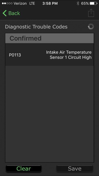

    Exterior: -Current Suspension- Icon extended travel front struts w/ 700lb coils Icon extended travel Remote Resi rear shocks Dakar leaf pack Icon Tubular UCAs with covers Icon neoprene shock covers -OEM Roof Rack -2 fold down cup holders in bed -Bed bottle opener -Access lite rider roll up tonneau cover -AFE Prodry air filter -Pop and lock bed lock -Rear differential breather relocation mod (behind tail light) -Aeroturbine 2525XL Muffler Armor: -SOS Concepts bolt on sliders W/ kick out -SOS Concepts aluminum front bumper with full hoops -SOS Concepts Rear HC Bumper -SOS Concepts IFS/Mid skids
    Installed all was good
    Then came code
    P0113
    Anyone?

    Not sure what the P0113 is, I am throwing P011B with the module installed ..

    Probably this models version of your code lmao
    I went and bought IAT cleaner and cleaned it, got Throttle body cleaner and cleaned my butterfly. Spent the entire day on this little project from 10am-8pm and the only thing I can think of is the bypass is either faulty or "not perfected" yet like the original one you got.
    Interested to see what Paul has to say, emailed him twice and called him once, maybe I'll hear from him Tuesday :/

    update:
    My battery was going bad and after I replaced my battery on Sat everything is working as should and fixed the problem. The bypass seems to be working fine :) Maybe didn't get enough juice on crank or something to kick it on. IDK but not complaining, no codes!
