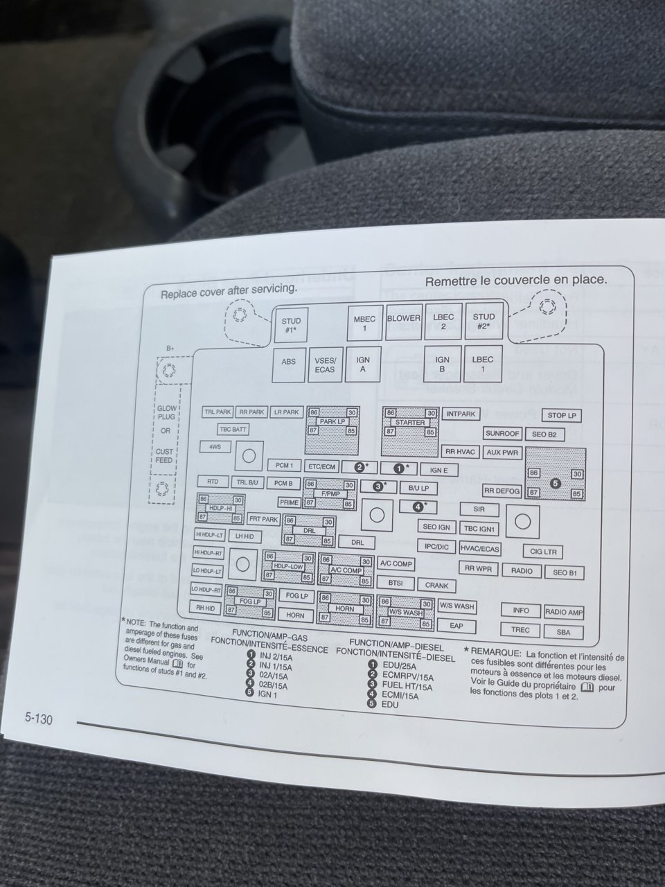

  7. Mar 5, 2023 at 1:17 PM
    super_white
    super_white Well-Known Member
    Feb 6, 2012
    #72230
    8,621
    Harry
    Connecticut
    2012 Tacoma 4X4
    I don't see an "ignition relay" in my wiring diagrams. Is it the EFI relay you're talking about?
    I can send you a wiring diagram once I confirm what relay it is.
    Cativelense likes this.

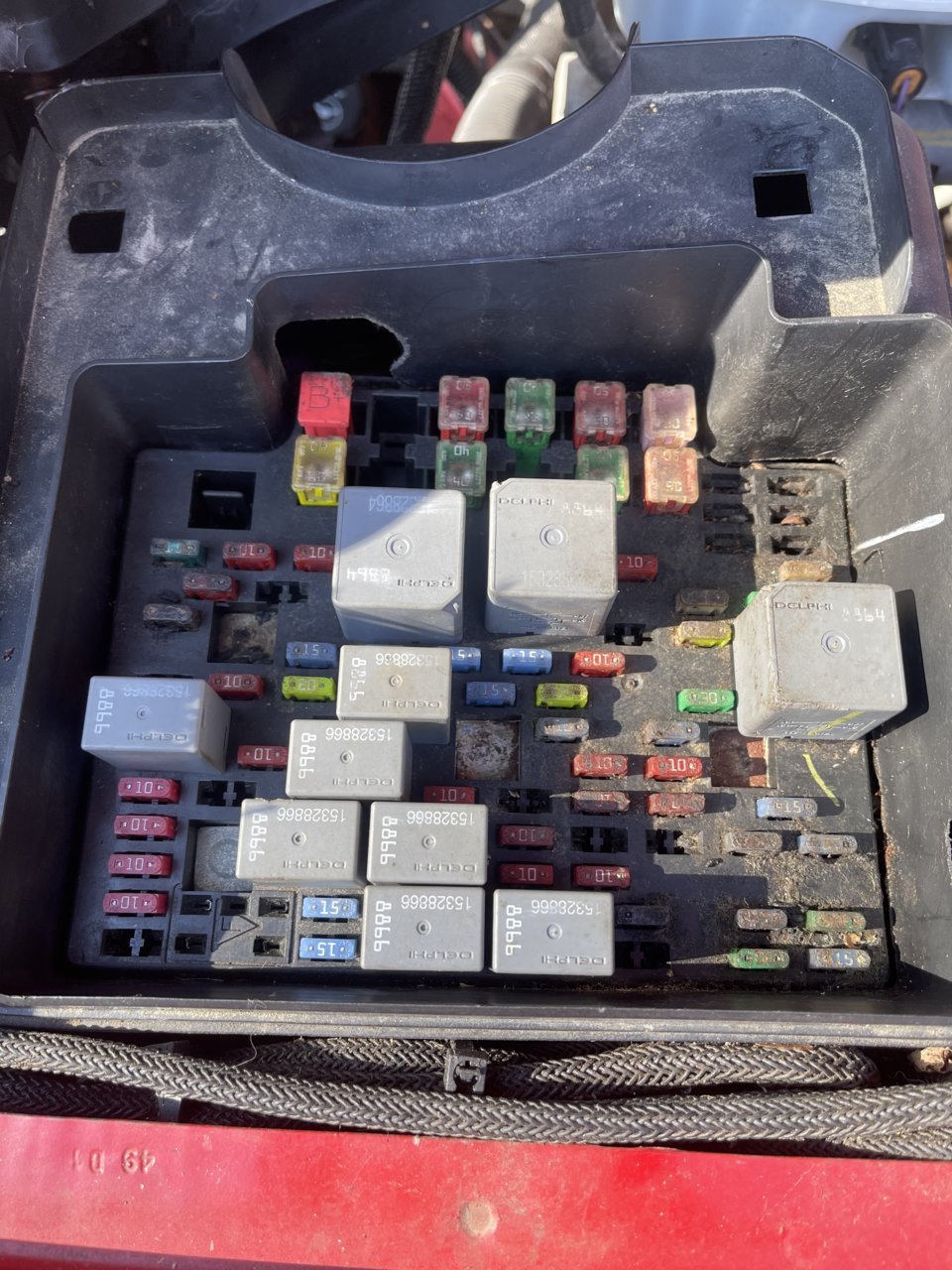

  8. Mar 5, 2023 at 1:24 PM
    MikefromCT
    MikefromCT Well-Known Member
    Oct 23, 2018
    #270327
    3,172
    CT
    2013 TRD OR DCSB
    OME Bp-51; Relentless Armor
    #5 in the pictures below267C022E-98E6-4FD3-A93B-58BA4E575855.jpg2D2B7570-68A6-4AD2-B27D-D3511BDD41D5.jpg

  9. Mar 5, 2023 at 4:45 PM
    TOMB
    TOMB Well-Known Member
    Jun 11, 2014
    #131765
    1,345
    Tom
    Newington Ct. 06111
    2013 Access cab Sport -super white
    Changed all drain plugs to Dimple Magnetic plugs UNI filter on air pump
    @MikefromCT
    Hey Mike, just an observation,
    With all that dirt/mud in the fuse box I'm guessing that it was wet a time or two.
    Appling my motorcycle trouble shooting skills it might be possible that some corrosion forming/formed on the backside of the fuse panel and is causing some very high resistance and connecting more the one circuit together.
    I'm offering a suggestion, Disconnect the battery and then remove each fuse and relay one at a time and check if there is any corrosion dirt, just by removing and cleaning the contacts might clean the contacts enough to make a better connection.
    Works on the Moto Guzzi.
    Hope you understand what I'm saying.
    TOMB
  10. Mar 5, 2023 at 5:08 PM
    Breakfast Taco
    Breakfast Taco Well-Known Member
    Jul 4, 2017
    #223169
    3,123
    SW CT
    2002 4x4 5spd 2.7L
    I was going to say Fluid Film vs. dirt/mud, but yes - what @TOMB said.

  11. Mar 5, 2023 at 6:58 PM
    MikefromCT
    Oct 23, 2018
    #270327
    3,172
    CT
    2013 TRD OR DCSB
    The culprit is mice. That round hole was created by mice and there was a pretty big mess in here at some point, but it was largely cleaned up with some peppermint oil being applied to keep them at bay. No apparent damage to the wires but I will keeping an eye out as I continue to try and figure this out.
    It definitely needs some more cleaning up, Ill give your suggestion a try. Thank you sir.

  12. Mar 6, 2023 at 2:58 AM
    super_white
    Feb 6, 2012
    #72230
    8,621
    Harry
    Connecticut
    2012 Tacoma 4X4
    I saw the rough edges of the hole and thought mouse. Plus that fuse block is really dirty (corroded?).
    You may have to pull that fuse block apart and do some further inspection/testing.
    What year, make and model is this in?
    You might want to pick up a can of this stuff: https://www.amazon.com/WD-40-Specialist-Electrical-Contact-Cleaner/dp/B00AF0OFVU?crid=27DK47AFZAV7&keywords=electronics+cleaner&qid=1678100259&sprefix=electronics+cleaner%2Caps%2C148&sr=8-6

  17. Mar 6, 2023 at 6:32 AM
    MikefromCT
    Oct 23, 2018
    #270327
    3,172
    CT
    2013 TRD OR DCSB
    04 GMC Sierra 2500hd -gas. Ill look pick some of that up, thank you for the suggestion.
