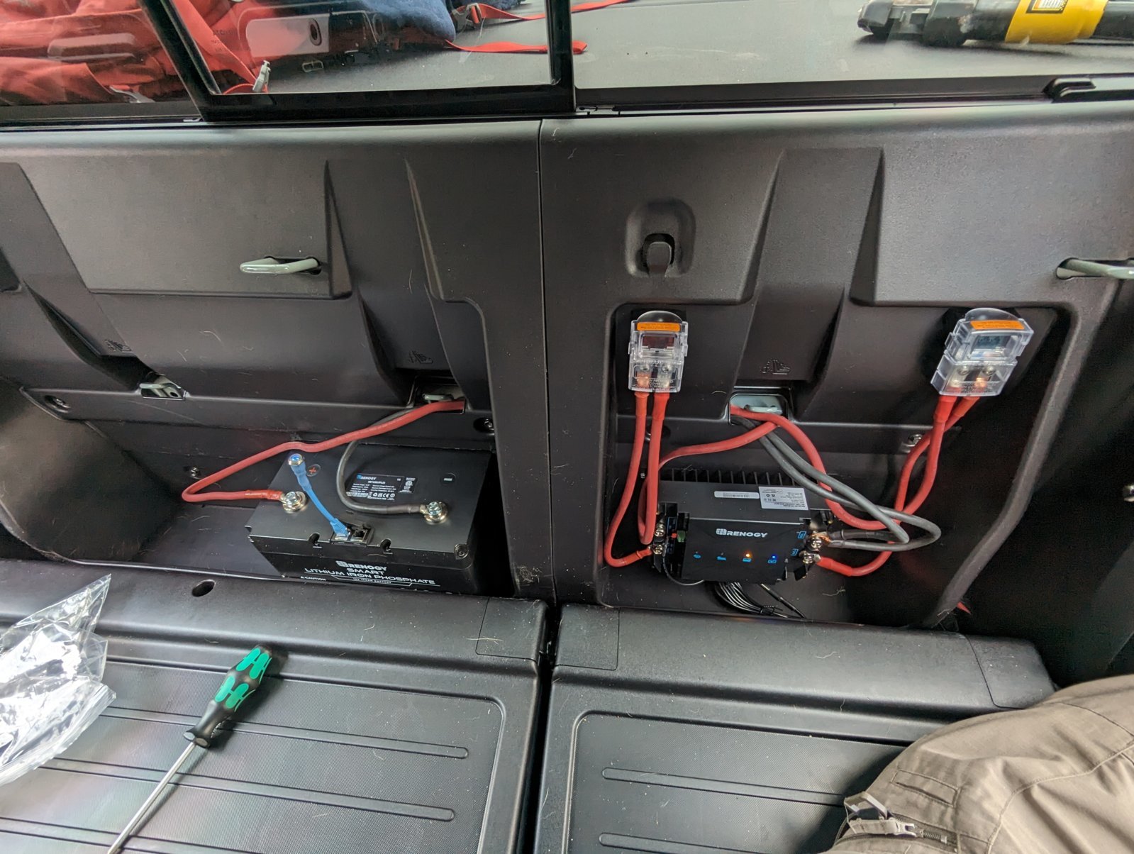

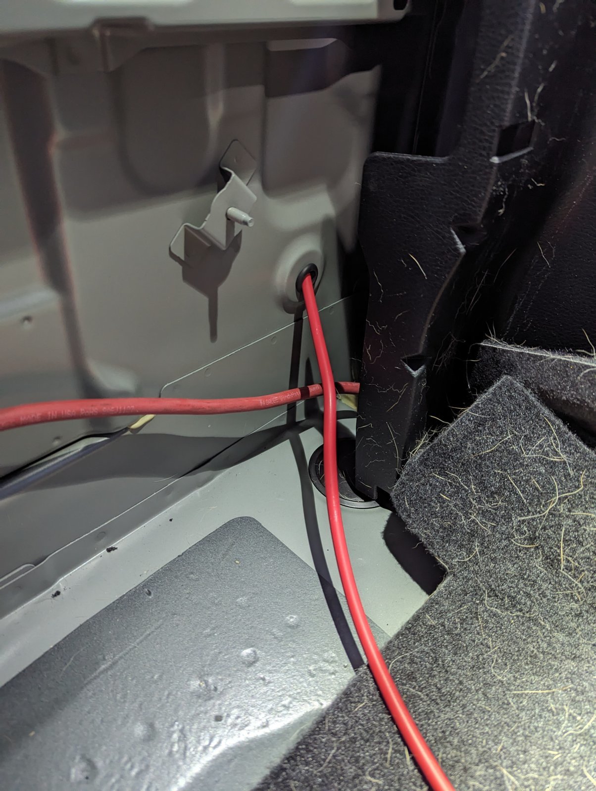

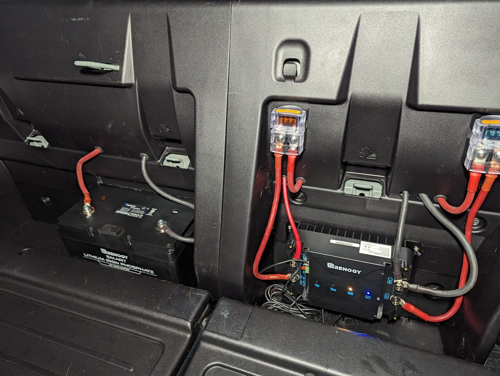

    Morning boys. Actually had a bit of free time last night. Was able to really clean up the wiring and wire up the solar panel. I found a gromet that was the perfect size on the cab wall on the drivers side.
    I was also able to fit the switch for the light bar properly so now thats done too.
    PS: ignore the dog hair please.
    Before:
    After:

    Nicely done!

    Nice job! :thumbsup:

    Thank you...I ran out of grommets running the wiring through the backs of the plastic storage cubbies. I need 2 more for the ground wires as the power wire took priority. Its also very thick 4awg welding cable from windy nation so I am not concerned in the least.
    I also need to add a circuit breaker to the solar power wire. The dc-dc charge controller puts priority to solar over the alternator for charging. Ill break the circuit when I am driving around etc and when I am parked and using power from the secondary battery, I will click it back so that the solar panel becomes the main source of power.
